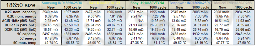

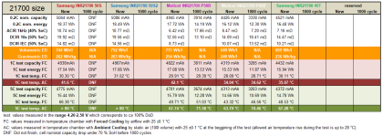

"High Power Rate" test (5C continuous discharge)
note: the 5C discharge test is performed at ca 100% DoD (4.20V-2.50V)
18650 size
2500+ mAh samples comparison
5C_18650_+2500mAh_test@DCIR10s_rise.png 5C_18650_+2500mAh_test@capacity_drop.png
3000+ mAh samples comparison
5C_18650_3000mAh_test@DCIR10s_rise.png 5C_18650_3000mAh_test@capacity_drop.png
21700 size
4000+ mAh samples comparison
5C_21700_4000+mAh_test@DCIR10s_rise.png 5C_21700_4000mAh_test@capacity_drop.png
4500+ mAh samples comparison
4C+_21700_4500+mAh_test@capacity.PNG4C+_21700_4500+mAh_test@energy.PNG4C+_21700_4500+mAh_test@DCIR10s.PNG
Graph below shows dT = Tend - Tstart (The difference between the cell body temperature at the beginning of the discharge which is RT: 20°C with up to 3°C tolerance and the body temperature reached at the end of the discharge). As a Temperature sensor is used NEWARE T-type miniature (0.2mm) thermocouple, attached with kapton tape.

BAK N18650CNP-25 and SAMSUNG INR18650-25R8
- both cells finished 1000 cycles at 5C @ 100% DoD. From this synthetic test BAK perform a little better, it gives more energy and in particular the increase of internal DCIR is significantly slower. On the other hand, BAK capacity/energy starts to decrease significantly after 950 cycles and so I assume, that it will be completely dead after ca 1100 cycles. Unfortunately I will not have access to the temperature chamber for next few weeks, so the final tests to complete the graphs and tables will have to wait.

added full data for 25R8 and CNP25, unfortunatelly I cannot find a 21700VTC6 Sony 1000cycle sample
small update after a while
added more graphs representing also 3C discharge rate for NEW and after 1000 CYCLE (both voltage drops + temp. rise)
