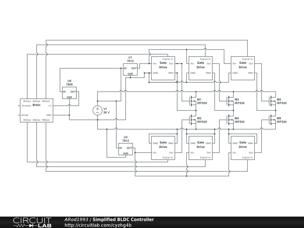

I was thinking of something more like a transformer that can step-up or step-down AC voltages with minimal losses. the only trouble with using one of these is that you need to change the number of turns of wire on the coils to change the output voltage, or maybe have a switch to flick between a set of small transformers with different windings. It wouldn't be too hard to retrofit one of these to the output of your controller if you really did want to change the voltage.
You can't do that, but you can do something roughly analogous for a simple trapezoidal three-phase controller. Instead of trying to retrofit transformers to the output of each of the three phases, what you do is put a buck converter between the battery and the controller inputs. Below is a simplified model of a three-phase brushless motor controller; the brain takes in throttle and e-brake signals,then converts those into six overlapping on-off sequences that it sends to the gate drivers; the gate drivers in turn pulse the MOSFETs on and off, controlling the voltage at the center nodes of each half-bridge. Here's the schematic:
1024x768

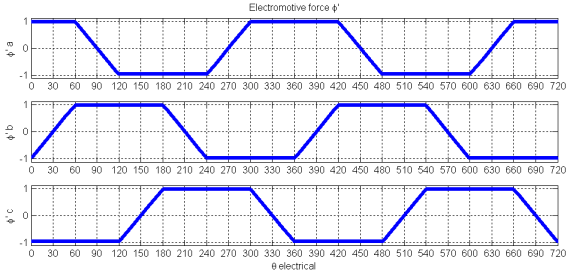

Basically, that circuit converts the DC voltage coming off the battery (shown there as V1, sitting at 36V nominal) into a set of three trapezoidal waveforms (one for each phase wire) offset from each other by 120 electrical degrees:
There are a couple of different means of controlling the voltage seen by the motor; the easiest is to simply PWM the high-side MOSFETs at a switching frequency (usually several kHz) far higher than the frequency of the trapezoidal waveforms, and I'm pretty sure that's what Kelly does. The other option, which I think has been done successfully in some commercial controllers, is to slap a controllable buck converter between the battery and the motor controller; that would let you adjust controller voltage on the fly, and (if your controller has current limiting) then you should be able to use the lower voltage without frying anything due to increased current.
I'm not sure whether you'd want to try to retrofit a commercial DC-DC converter onto a motor controller (since as far as I can tell most of the cheap eBay ones are only good for a few tens of watts), but if you're designing your own controller you could just integrate an extra few half-bridges (with supporting passive components) onto the input stage and use some sort of twist pot or rotary-switched resistor array to set the duty cycle (and thus the output voltage). If you're not doing that but you really want that kind of functionality, get a cheap brushed DC controller, tie the throttle to a twist pot or a rotary-switched resistor array, and put that between the battery and the brushless controller.
