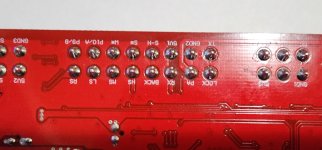

You could try this, The 16 pin connector on the speed controller is actually only using 6 of the pins. Looking down at the controller with connectors at the top. The bottom row 2nd from the left is LS and the third from left is MS. The 4th pin from the left is HS, but is not used. Try moving the MS wire to the right one spot. Let me know how fast it os after. I already changed mine to fardriver. So I can't test, but looks to me Like it is Low Speed, Medium Speed, then HS would be High Speed. Makes sense. Most speed controllers are 1 speed or 3. Never seen a 2 speed before.
Some controller pics.
