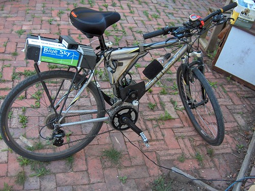

Here are some pictures of my bike:
Version 1.0

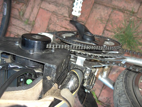

This configuration with a 9 tooth motor gear and a 90 tooth crank gear along with a 24 tooth chainring resulted in a top speed of ~24 mph in top gear. However whenever you wanted to pedal it was rather retarded with only the 24 tooth front chainring.... I also didn't like my motor mount so I revised...
Version 1.1
This bike has a lashout gearhead, 4.7-1 ratio then goes from a 17 tooth motor gear to a 90 tooth chainring resulting in a cadence of about 112.
This version has a chain tensioner and a little different motor mount utilizing the water bottle holder bolts. This has a 26, 39 and 52 tooth chainring on the crank. This results in a range of speeds from 9mph to 30.6 (theoretically) more realistically a top speed of ~25mph without wind.

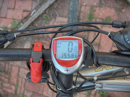

I have been riding this version to work for about 10 days (only 6 workdays) and haven't riden every day but I have riden ~155 miles in the last 10 days. I average anywhere from 20mph to ~24 mph depending on wind, and with a tailwind today I averaged ~26 on the way there and about 19 with the headwind in the afternoon (a vicious headwind)
Anyway Heres what I built..
The only problem I am having is that the internal 24v controller on the kolmorgen motor seems to overheat after about 8 miles at 23-25mph... it overheats at ~185 degrees f on the controller side of the motor. Then it takes a couple minutes to cool back down and turn back on. I ride about 8.5 miles each way to work everyday so some days I have to pedal other days I make it just fine.
I am really wanting to get an external crystalyte controller for at least 48 volts and run this thing at a higher voltage with an external controller. I think it will really come to life with that!

I like it! good use of a stock Kol motor! and yes you will notice a significant increase in performance with a modified motor such as mine, I can run 1,600W if I need to! that should be enough for your tranny! may accelerate quite well! I am going to do something similar driving through a Nuvinci geared hub.
The stock controller in those Kol motors is rubbish, I would scoop it out and put an external controller to it, it will all run much smoother and more reliably with a heck of a lot more power.
Thanks for the pictures!
Knoxie
The Kollmorgen motor is much easier to wire for an external controller than the BMC motor. I'd guess about half the heat is coming from the controller with the stock setup.
