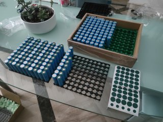

1/ fill in gasketed cells in holder brackets:

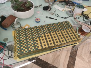

2/ welded cell with busbars with insulating polyamid and paper:

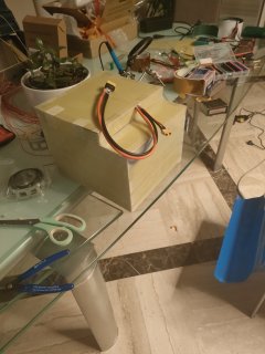

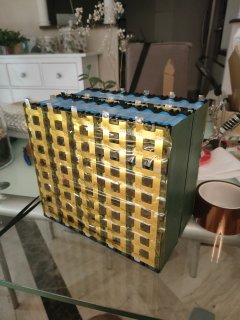

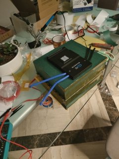

3/ bend the flat pack to 2 layers separated by a 2mm epoxy plate and prepare the rows for the bms wiring:

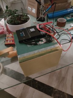

4/ wrap up with insulated paper and stick the bms:
5/ connect the bms wires to each rows (schema are quite clear) and sorry, I've lost the photo with the wirings...

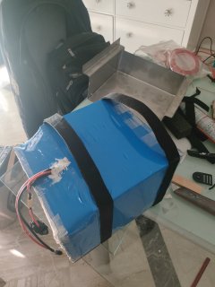

6/ Full enclosure with 1mm epoxy plates and with XT60 charge and XT90 discharge connectors

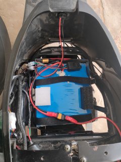

7/ double protection with PVC and straps (15kg !), custom steel sheet to protect the battery in the enclosure
8/ Finally, the battery is in the escooter enclosure:

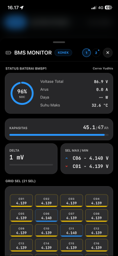

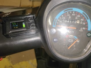

Since the JK BMS embeds BT and the initial analog soc gauge was only fit to manage lead battery, I used a lilygo chip (ESP32) to connect through BLE to the BMS and display real time SOC, voltage and current discharge/charge:
To be honest, Claude.ai wrote almost entirely the initial program (C++, ARDUINO IDE) following my specifications:
- display SOC (number and gauge), voltage and current
- button up: long press activates wifi for OTA
- button down:
- short press : switch SOC/remaining distance
- long press: force last choice (SOC/remaining distance) at start up.
The lilygo has an initial enclosure. I designed a larger PETG enclosure (freecad/anycubic kobra 2plus) and use some silicone tape to make it waterproof.
