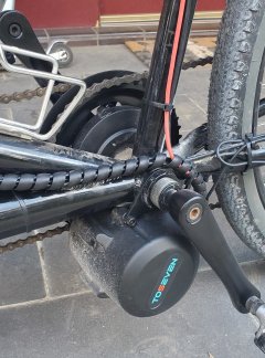

I am trying to put a DM01 on my tandem (Avanti Tandem 2017) but having issues because there are chainrings on both left and right sides of the crank. The bottom bracket is 68mm, so we tried to fit a DM01 this afternoon but the left chainring interferes with the left end of the motor (first picture).
It *looks* like the DM01L should clear the left chainring but I am not sure because the diagram provided by toseven is incompletely dimensioned. The pictorial representation seems to be 1000W (127mm motor) assuming it's drawn to-scale, but who knows?
So I have two questions:
* does anyone have a more-complete CAD diagram of the motors, and
* has anyone fitted a DM01L using sleeves to adapt it to a narrower bottom-bracket?
Alternatively if you have DM01L, could you measure that clearance for me? At the very least if someone can confirm that the motor face does not protrude beyond the end of "Decorative Ring (3)", then I think I'm all good.
I could machine up sleeves totalling 32mm length so that the DM01L can grip a 68mm BB but is that going to cause me problems e.g. an insecure fitment? I haven't yet worked out whether my chain paths will be too wonky with the longer crank shaft length but I think I can make them work.

Update: the motor is installed and working. I couldn't get a working front chainline on the left that would clear the motor, but it turns out there is loads of room on the right side. I made it work - completely straight chainline - by widening the front crankset using the following parts:
That puts both chains on the right and the stance is a little wide but then so am I. The front cranks are still very slightly narrower than the default cranks on a DM01, so it's quite usable; I did 100km on the weekend including a 72km tour with my 11yo on the back.
Attached: a bad photo from the wrong side which shows the motor installed; you can see the two chains. Still waiting on my big battery (2.5kWh LiFePO4) to arrive from China but I borrowed a 700Wh battery in the meantime and it gets slightly better range than I expected.
Now I just need to fix what looks like integrator windup in the speed-limiter, which means you get no motor power for up to 15s after coming off a big descent.

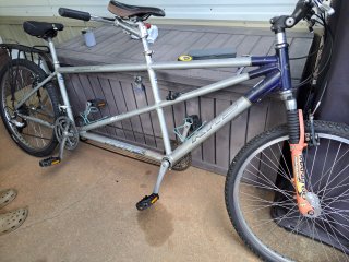

Congratulations on your installation! I have a customer with a Tandem and he'd prefer a DM01 on it and it appears that the rear BB is the place to mount it, like you've done. The picture in the thumbnail is of the underside of the rear BB and the clearance issue I'm having with a TSDZ2 motor I had laying around in the shop. Please note the mounting lobes are not quite clearing the underside of the frame there and would require removing two or 3 mm of material on each side and thus weakening them. Do you have any pictures showing the DM01 clearance on the underside of your tandem, that you could post here or send in a DM? Like I said, his preference is to mount a DM01 but I first want to see how much clearance you have. BTW, it's an old KHS tandem like this one. I believe it was called a Tandemania. Which tandem do you have?
Tandem BB clearance : 20250924_142018.jpeg KHS tandem : 20250811_175724.jpeg
