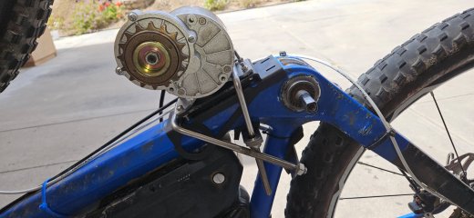

3. The motor cradle's bolt holes are offset about 10mm to the left side of the frame. That means the freewheel is further inboard than a normal dual chain motor. And because the cassette-driving chainring MUST be the inner chainring (or the chainline will become unusable in lower gears), the inner chainring will be pushed in even further and the max is probably 42T. I'm running 40T.

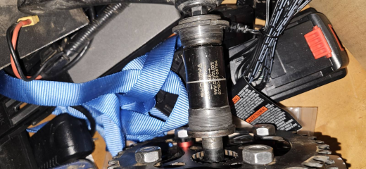

4. Crankset and spindle: If you mount the cradle a few inches up the down tube, you could run a standard Hollowtech or similar (SRAM, etc.) crankset that won't hit the motor or freewheel. I played it safe and used a 148mm square tapered spindle with a right-hand extension. Because the next symmetrical size down for a 68/73mm shell is 127mm, that 21mm difference may be too much for the right crank to handle, because both sides clear by about 15mm each, so you either use something like pictured below or mount the motor cradle somewhere away from the bb. Chainrings spaced 4-8mm from each other (they will not rub) and 8mm of spacers between the right crank spider and (outer) chainring; both are inside the spider. Inner 42T or less for cassette, outer can be anything between 30-52t 104 BCD. You'll need at least 30mm to bolt everything together which means standard chainring bolts are out. M10 40-50mm will work fine.

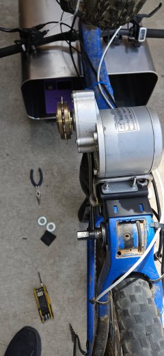

6. Mounting: This took a while to figure out but it's actually straightforward: you use metal strapping or U-bolts on each end of the cradle. See images below. I later changed the bb-end U-bolt's plate to be inside the seat tube, and taped 15mm of mending plates to wedge into the triangle corner between the carbon frame and the U-bolt plate. Then shoved a 2nd U-bolt next to the first one; they will be slightly offset and that's not a big deal. The inner U-bolt diameter is 76mm and the cradle's outer is 74mm, so thats close enough that the bolt sides act as shear plates and lock in place. I used 6.7 inch ones; you can probably get away with 4-5 inch ones, especially if you can use the top of the down tube. They will work. Just don't go crazy torquing the bolts forever. If you don't have a Hailong battery on the downtube, you can directly U-bolt from the top to the cradle. I also used a few zip ties in the cradle's open slot just for overkill. The cradle makes this work for many different mounting possibilities, don't worry.

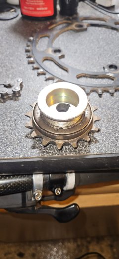

7. For the freewheel, I just happened to have one laying around where the adapter keyed side was 'wrong' so I flipped the freewheel, bolted on to the shaft, and it worked. Just remember to matach right hand to right hand, left hand to left hand. Don't do the below left-hand freewheel and right-hand adapter:
