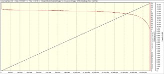

I built a 16 cell 48v Headway Pack for a mate, this pack uses 16Ah cells and a BMS from Headway Headquarters... link below...
http://stores.headway-headquarters....-bms,-16-cell/Detail.bok?category=BMS/PCM/PCB
upgraded to: SignaLab 30A Nominal 60A Cutoff PCM/BMS W/Led's
The controller is a standard 12 Fet Infineon from Cell Man along with the nice Mac Motor with the stronger gears.
Problem 1:
First the charging FET on the Signlab BMS was getting so hot that it was melting all the solder off, I changed it to a fet from one of the many broken BMS's that I had kicking about. That seems to work now, no heat at all when charging. Maybe the 12A charger was too much for the BMS? But it was boiling the solder at 5A charge as well?
Problem 2:
This is the main problem, the bike would run for no more than 2 miles before it would stop, pulsing the throttle would give you maybe 2 secs of power before cutting out. So the BMS was shutting off the pack for some reason.
Testing:
So I test each BMS sense wire, yep all working all voltages around 3.3 on rest. Problem is with LifePo4 cells you never really know how far along the discharge the cell is due to the voltage holding flat until discharged.
Anyhow I decided to take the whole pack apart and discharge each cell from full charge to 2.1V using an iCharger 1010B+. This charger can only discharge at a max of 7A even on a single cell.
Observations:
None....not one of the cells go past 15.2Ah on a lowly 7A discharge, this is lower than 0.5C. The Internal Resistance measured ranged from 27mohms to 33mohms.
One Cell which is Cell 13 only gives just over 13Ah at a 7A discharge! Question is would this cell at 35A be sagging down low enough to trigger the BMS?
Here is the Graph for Cell 13 form the iCharger 1010B+

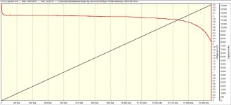

Here is one of the better cells...remember these are 16Ah at 1C and these were discharged at 0.5C
