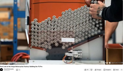

I just thought why not looking at WHAT THEY'VE DONE YET in order to have an idea on WHAT THEY COULD DO...
Just like my other post in the motor section I used one of their video fast images that I slowed down and "snapshoted" each to see precisely what's inside!
Verge Donut motor
Here are my observations:
- They are in 4 modules of 24s12p each for a total of 96s12p 350Vdc 60Ah for their current 21kWh pack
- Each modules use what seems to be NCA LI-Ion Molicel 21700 P50B cells ( because of the beige color) mounted vertical
- Believe it or not, these P50B Molicel spec indicate -20 celsius charging!!
- The busbars look like nickel plated copper or nickel sheet and are top & bottom, not single side welded
- These busbars are spot welded with a X/Y automated machine and use a Kweld spotwelder (see on teh tablet above the desk! probaly for rework)
- The BMS wires look like old IDE flat cables rainbow colors like old TRS-80 computers had for expansion modules
- They use fiberglass reinforced tape
- I like their ELECTRONIC LOAD ( battery tester).. it is a bidirectional
- Their BMS seems to use a BQ serie chip from TI ( typical rectangle and not square smt)
- They use nylon nut and bolt for the output busbar to connect to other modules and output HV lead
- They have their own cell sorting machine
- They spotweld modules output busbar together
- They use an appropriate cell spacing ( the transparent cell holder tell that) I guess 1.25 to 1.5mm
- It seems they use "U" shape top and bottom metal sheet plates as structural element as well as maybe for side cooling the modules.
- There is a insulating sheet and black ashesive or epoxy to glue these plate to the cell modules
