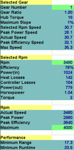

dirty_d said:
...whats the usual riding distance for a 48v system with 12Ah batteries
If I plug the numbers into the spreadsheet I get this for such a bike. Note that this is assuming flat land and it includes things like wind resistance losses and a bunch of other stuff. It's also assuming a 13/114 gear ratio, so to get more precise I need to know the number of teeth on all your sprockets. I'm also assuming a 40 amp controller.
