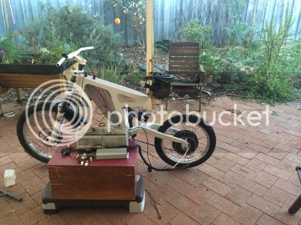

BEEN GONE AWHILE....SO heres the deal: going back to 100 volt system one of my cells fried due to rubbing on screw points inside frame getting new controller and new motor optimized for 100 volts (basically same motor as my 4065 gonna just switch internals) also gonna finally have a cycle analyst display...hopefully by next week be on the road...also ming had a photo of a bunch of frames..you working with david ming?
jesset33 said:
Installed the 5305 :D 76v 45amps
Pulls like a freight train
no doubt. well done.
so when are you upping the amps? if you have a Lyen/infineon controller you could reprogam it fairly easily. also they have the 120% speed seting so you can get that extra bit of super fun. what controller do you have on it now?
Finished my precharge for my new 18 fet4115 lyen edition and plan on checking phase and hall combos tomorrow.
When I'm happy with the way it running then I'll install the controller.
Exciting times ahead. Might do a small vid tomorrow and then my cameras going on holiday
