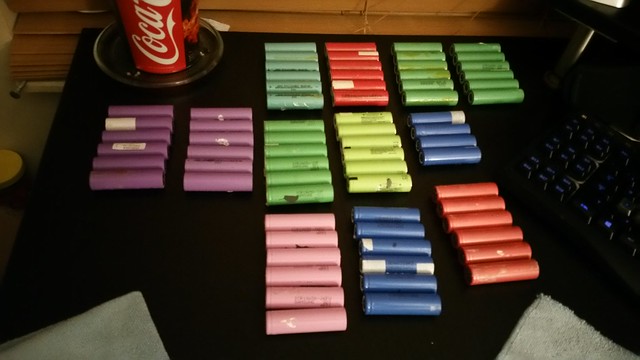

Well i think i pretty much made up my mind, i am probably going to order the Mac Geared Hub motor w/ 10t setup in a 48v x 26" wheel configuration.. I need to figure if i should upgrade controllers or not.. but i did pick up some laptop batteries yesterday and today i broke them apart, i have checked them over with multimeter.. all were above 3.0v except 3, so untill i test capacity of them to figure out if any are weaklings, i have around 78 cells already for my pack build.. I also ordered tonight an Imax B6 Mini Pro V2 w/ 108watt power supply off amazon for $44... i did a lot of shopping around and it was the cheapest i could find on any Genuine Imax... This one is coming form SkyRC themselves, so i expect it to be the real one, plus after reading about the different models i learned the mini pro can be connected to the PC and Phone through wifi and android app and see the actual graph of the discharge current from the cells and the new mini v2 is suppose to have the 0.1 more accurate resistor mod on the balance circuit that is commonly modded on the other models straight from the factory...
I plan to check out a few more stores to try and double my cell count, so i can have more cells to choose from on building the pack..Here is what i got today from the batteries...
The B6 is going to be ~very~ slow discharging your cells, they do discharge but it is limited to just five watts total. If you have five cells in series for about 20V then you can discharge at 5w/20v or 0.25A which will take roughly ten hours to discharge the 5 cell pack. An 18650 cell holds 7-10 wh usually so count on two hours discharge time more or less per cell.
I ran into this myself, bought a IMax B8 thinking to use it to match cells and found out quickly it can do the job but so slowly it's very annoying.
A Cellog 8s, a wattmeter, a switch and some 12V automotive lamps will make you a much faster discharger for testing batteries.
One other point about a slow discharge, it's hard to find the cells that have a high internal resistance that way and those are the ones you want to weed out of your pack. You really want about a 1C discharge rate on old laptop cells for testing purposes, you'll likely find a number of them that get hot and have a higher voltage drop, they are unsuitable for your purposes.

Actually, i thought about this... i bought the new gen 2 Imax B6 mini, it is a higher 60w/6a unit and its discharge capacity is up to 2amps over the original unit.. and from what i understand after my reading is if you hook 6 batteries up to it through the balance port, in the computer software you can set it to discharge each cell in the 6s configuration.. so you set it to do 6 and let it be while you do other stuff in the room....
Also, the mini model has the 25 second internal resistance tester feature the older ones dont have also, should i check them all through this process first before looking at capacity?

Yeah, high resistance cells and cells that leak down significantly should be eliminated before you start capacity matching if you want to save time.. Good to know about the new charger, that's quite a useful upgrade to the old capability.
Charge them all up and let them sit a week, longer is better shorter worse, get rid of any that drop voltage significantly in that time then test the internal resistance of the rest. Getting rid of leakers will save you a lot of trouble with the pack later, questionable cells aren't worth the effort they can entail in troubleshooting. I had the best success not worrying about brand or number but putting together matched capacity banks strictly by measurement, put low cap cells with high ones and low resistance ones with high ones to get all your parallel strings as near matched as possible. Remember to use Ohms law to parallel resistances when matching. 1/Rt = 1/R1 + 1/R2 + 1/R3 +... A little spreadsheet can make it a lot easier to match up the cells, then all you have to do is move them around in the spreadsheet and recalculate til you find something near optimum.

Why do none of your cells have tabs left on them? Proven factory battery connections are a mistake to give up, because it greatly increases the work as well as pack failure risk.

If you use 33 or 34 gauge (skinny) copper wire to solder to the individual cells from a bus bar they can act like fuses at around 4-6A per cell. It's also so thin it's really vibration resistant since it bends so easily and allows the cells to move a bit without breaking the connection. I wouldn't worry about welding used cells, go ahead and solder, even that is going to take a while and welding with shade tree equipment is going to be frustrating and slow.
Using a bunch of old mixed cells in a high drain environment is fairly hazardous, the individual fusing really helps in the fire safety department, just like a Tesla pack..
What you don't want is one cell in a parallel group shorting out and then the rest of the dozen or however many parallel cells you have dumping their entire charge through that one cell, it's about a guaranteed fire so you put the fuses on each cell so if any one cell shorts the fuse wire blows and isolates that cell from all the rest.
