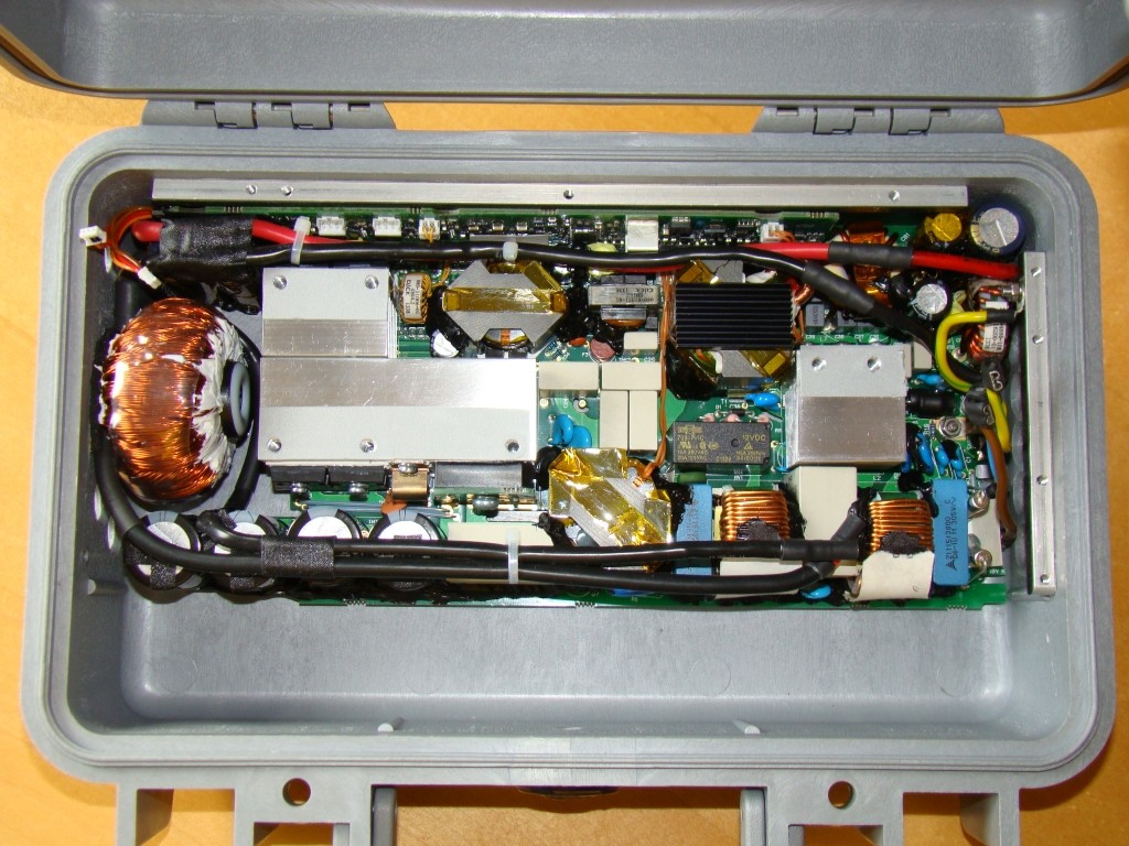

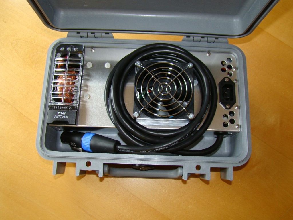

From left: Eaton, Adaptto Max-e, 1500W Cherokee CAR1248FP
![DSC04713.JPG DSC04713.JPG](https://endless-sphere.com/sphere/data/attachments/85/85036-c3eb1cfad739588361b040cb6f29dedc.jpg)
Wiring:
![DSC06987.JPG DSC06987.JPG](https://endless-sphere.com/sphere/data/attachments/103/103508-aff966348e6ff96707e77543167b7a38.jpg)
Using powerful iron really helps and you dont have to remove the cover to solder on the wires.
![DSC06980.JPG DSC06980.JPG](https://endless-sphere.com/sphere/data/attachments/103/103509-ea56a777448022d322289a917100164a.jpg)
Charging trough Adaptto Controller with 30A Coil
This is how much it drains from the wall at 21A charging current
![DSC04699.JPG DSC04699.JPG](https://endless-sphere.com/sphere/data/attachments/85/85037-cfd245366935774b9f583fd408ea2e9b.jpg)

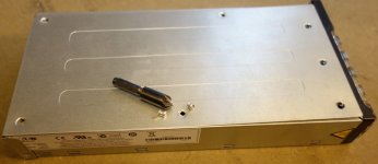

Firstly, drill carefully out the pop rivets to gain access to the insides.
Slide out the board and flip it over.
