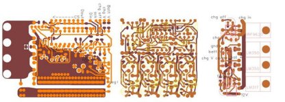

The BMS:
Uses a PIC 18F26k22.
The schematics for the high and low boards:
Changed the way the balance current optoisolators interact. (Thought putting batt V accross a 36V part might cause dependability problems.)
Didn't bother drawing the CPU, just labeled lines that connect to it. Most of the unlabeled resistors would probably be 10k, or haven't been determined (depend on the number of cells, etc.) I also reduced the trickle current in the LM317, but didn't relabel it (that resistor would also vary depending on the # of cells). The lines labeled 'chg control' and 'Out control' would be connected to PWM.
The Balance schematic:
The ADC is basically a block diagram, no PS caps or current limiting resistors shown. I'm using an optoisolator to switch power to the ADC (low current and duty cycle), so don't need a seperate drive to it's CS pin.
The BMS uses 3 different boards. Designed so no one part failure can cause an over charge. (I just 'finished' this yesterday (Dec 4), so it probably has numerous mistakes (statement proven
The board on the low side (negative) has the processor, I/O, output control, precharge resistor, current measurement, and provision for 4 (or more) thermistors. There are ADC chip selects for up to 7 balance boards (28 cell). The chip selects can be used for thermistors if you use less than 7 balance boards. With 5 balance boards there would be 6 thermistor inputs. Measurements for current, batt V, chg V, and the neg output (voltage across the precharge resistor) down to -20V. Includes the multiturn pot to adjust the peak charge voltage.
The center board in the picture is a 4 cell balance board, can use up to 7 of them. Uses a multiturn pot and an LM431 to control each cell voltage by bleeding current through a 13 Ohm resistor. When the shunt current reaches about 200mA, a second LM431 starts pulling current through an optoisolator, all of which are wired-or and used to limit the charge current and notify the CPU of the condition. There is also an optoisolated ADC which the CPU can use to monitor cell voltages.
The third board has the voltage regulator(s), a mosfet so the processor can shut off all charge current, a trickle regulator, and a crude 12V regulator for the 5V prereg, and output fet drive.
They're designed to stack above 5Ah, or larger LiPo.

If you have any constructive suggestions or criticisms, please post or PM. (One thing I forgot and just remembered, was I intended to provide for a capacitor paralleled with a high value resistor to provide chassis grounds, in the hubs, to the frame, and to the handlebars...... Can be incorporated in the harness....)
