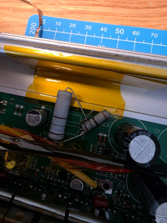

With a bit more investigation I noticed that the 5V lines (Red/Black) or the throttle, sensors and Hall-sensor plug all read 0.4V instead of the nice ~4.5V i'd expect. I unplugged everything but had the same results. Something must have broken on the 5V circuit which is used for Brake Sensors, Throttles, Etc. So I cracked open the controller for the first time since owning it (5 screws on the non-wire end and 5 on the wire end and lift off the top panel, mine was lightly glued)
The 5V circuit is powered the following way:
48V (Battery Voltage) <-> Current Limiting Resistor (180 Ohms) <-> LM317T Regulator <-> 15V <-> 78M05 Regulator <-> 5V Circuit
TLDR: The large 2W resistor (180 Ohms) had blown and prevented the entire 15V and 5V circuit from getting any power. The circuit is needed for throttle, hall motor sensing and brake sensors. I replaced it with an uprated 5W 180 Ohm resistor and everything now works!

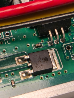

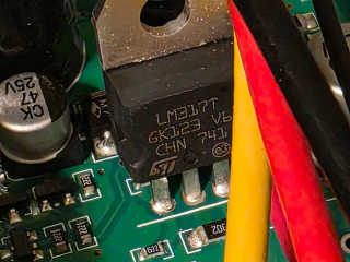

Working backwards with a multi-meter, I found the 5V 78M05 had 0.4v input and 0.4v output. Not the problem. Next up the 15V LM317T regulator. The output of this was also 1V, well below the 15V expected. The input for the LM317T was ALSO 1V. So this means it is not the problem.

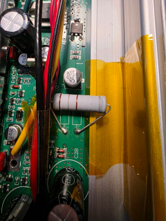

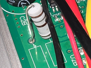

The next obvious thing in line was the large Current Limiting Resistor between the 48V (Battery Voltage) and the LM317T Regulator. This looked as if it had got a bit warm and the ceramic coating had cracked (and it had touched a nearby ground wire and melted the insulation). Testing with a multi-meter showed no connection between the ends of the resistor. It had fried preventing the entire 15V and 5V circuits from getting any power!
The fix: - I simply snipped and desoldered the leads of the faulty resistor and replaced it with a larger 5W resistor soldered onto the same pads. I put some kapton tape around for good measure to prevent any accidental contact between anything else.
Old vs New Resistor size! (2W vs 5W):
The 15 & 5V components for reference: 78M05 and LM317T
