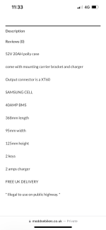

Ye mate complete kit from moddsebike they sell 100s. And spoke to speedup another local place and there kits exact same. Will have to buy a new battery and hope for the best can’t get any other batteries that are higher amp than 20
There are plenty of 40 amp batteries for sale. Are you getting confused between amps (A) and amp hours (AH)
Amps (A) is the maximum current that the battery can deliver.
Amp hour (AH) is the maximum current that the battery can deliver for 1 hour
So a 40A 20AH battery can deliver 40 Amps for 30 minutes.
That battery matches your controller. Although it is only just good enough and doesn’t leave any margin.
