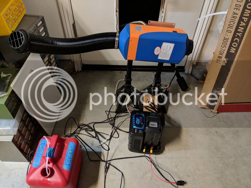

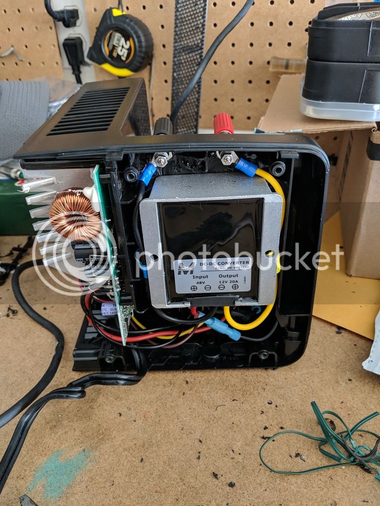

Hello, new user here looking for help with these Echo batteries (although not necessarily EV related). I have a small collection from getting the various tools on closeout (line trimmer, blower, hedge trimmer, and likely the "chainsaw" soon), 4 batteries along with 4 chargers. I made one of the chargers into a portable 12v power pack, but would like some more capacity since I have the extra batteries sitting around. Required: they still need to work with the yard tools, so no disassembling or modifying the external case.
Attached is the diagram of what I built (blue square) and the proposed parallel batteries. Also a picture of the power pack running the diesel air heater in my garage as a test. I am assuming there is not really a problem paralleling if they are all charged to the same voltage. But can they be charged as a 3 battery pack off one OEM charger as indicated? if not, is there an aftermarket charger that will charge them at once?
Calculated capacity at 204 watt hours x 3 x.95 (buck converter efficiency)= 581 Watt Hours. 581wh / 12v = 48.45 AH battery pack.
Buck Converter: https://www.amazon.com/dp/B01ENGOA4S/ref=sspa_dk_detail_3?th=1&tag=viglink20599-20

So what flippy and others are advising is that running parallel packs isn't recommended. OTOH I am actually doing the same kind of project as you, 60v 4aH batteries to run a Bafang with a DROK buck converter to protect the Bafang electronics. Lately I inclining toward the 58v Echos because I can eliminate the DROK since Bafang computer has an over-voltage threshold of 61.5v but not more. Another thing I like about the Echo 58v batteries is the thicker rail guides which makes fabrication easier. Greenworks has slimmer rail guides but DIY rack mounts are not very difficult for either brand.
Personally I am going to follow their advice and install battery isolation switches, cheapest off the shelf option for me is the ones used on RVs and boats to manage dual batteries. For three batteries, that would be a second isolation switch since it's difficult to find switches for a triple set of batteries. A single-pole, triple-throw switches(SP3T) are expensive so it's cheaper to just get two of the dual battery isolator switches.

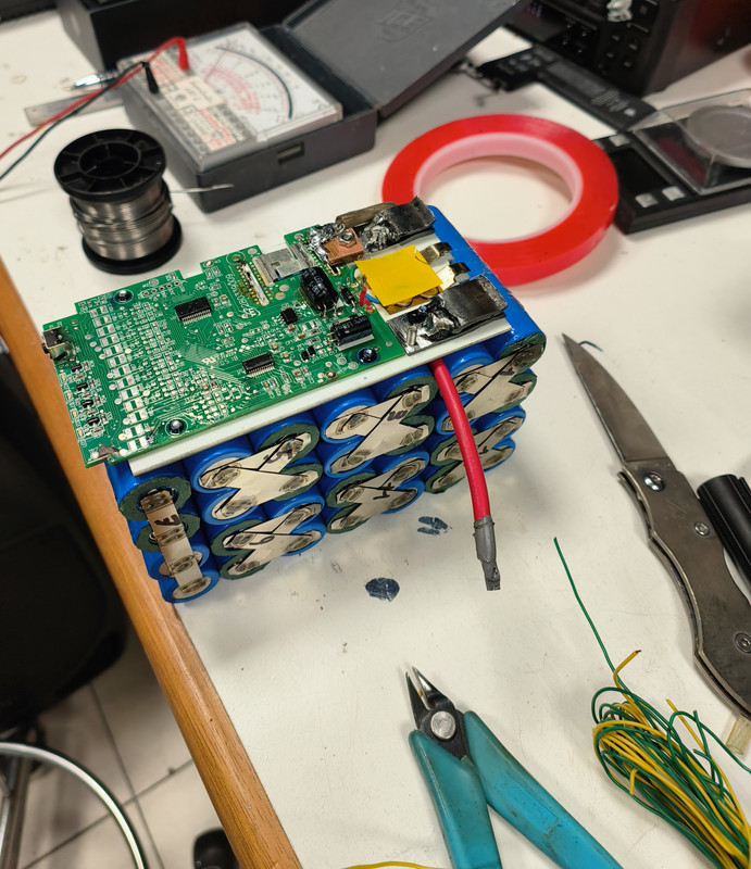

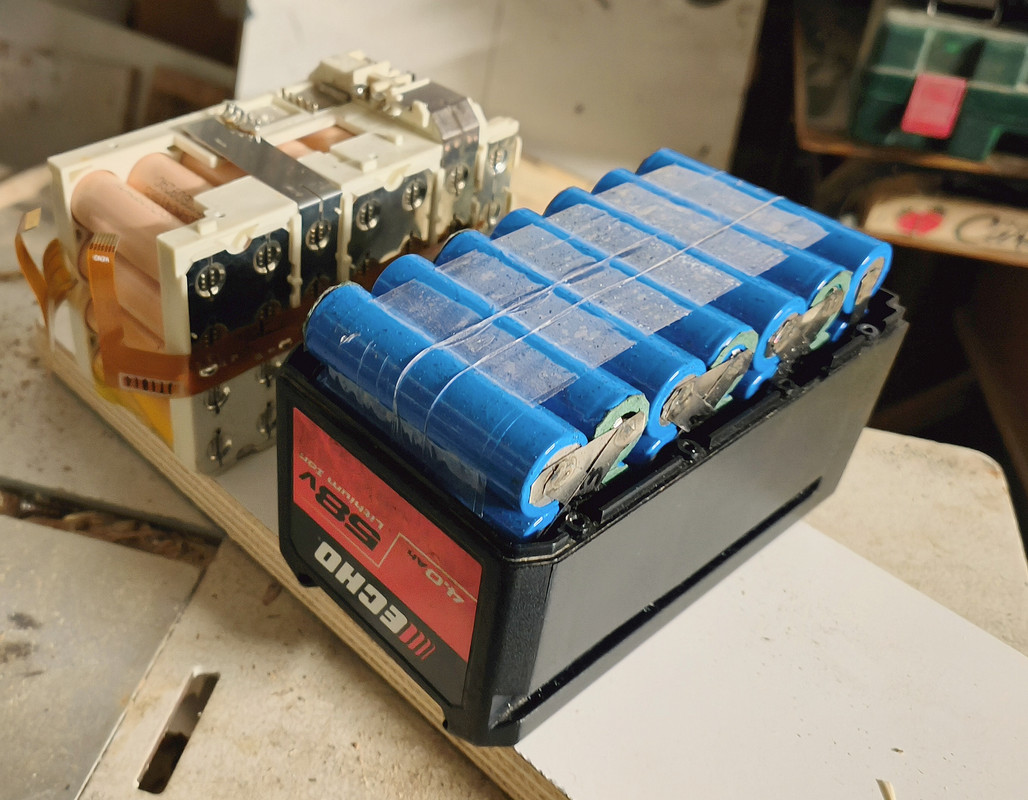

.Hi.
My chainsaw battery dont last enought this winter so i decided to recell It.
Once i opened the Echo battery case,figured out large amount of unused space,so i created a new precisely fit battery pack with 21700 Sanyo ncr2170c (3500mah 30A ,best cost-effective Cell on nkon.nl).
And Stick the original control board on It,with new handmade terminals.
Now this battery weight 2.2 kg and have a capacity of 7ah.
Hope this can help someone
