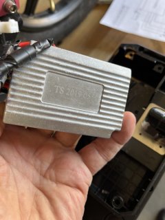

Many years ago, my son's family purchased an Ecotric Swallow 14-inch ebike. It worked well for them for them and they had fun. Then it just set in the garage.
Recently my granddaughter expressed interest in riding it. By then the battery was completely dead and they asked me to see if I could bring it back to life.
They had lost the key to release the battery so I first picked the lock and got it off. Eventually I was able to bring the battery back to life (shows 41.6 volts) and reinstalled it; however, it wouldn't turn on.
I contacted Ecotric but that bike is no longer supported and they could not give me any information about it except a generic wiring diagram.
The display is an 810 with 6 wires.
The controller is marked LCO3614E1H-TS22 and on the top reads TS 2018 05. It is tiny about 3.1 X 2.1 X 1.1 inches (80 X 54 X 31 mm)
I attempted to test the controller with a multimeter. The "plug" to the motor reads 41.6 volts and I assumed that some of the other plugs should give a voltage reading, either 41.6 or 5 but none of them show a voltage. My first question is shouldn't the connector to the display have voltage from the red and black wires? In fact, I would think that all of the connectors that have a red and black should show voltage, shouldn't they?

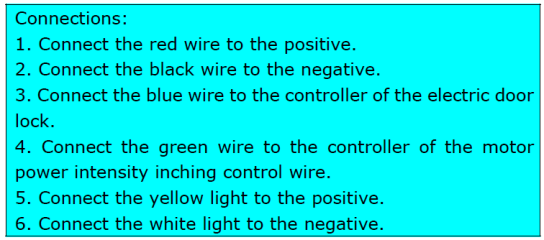

Regarding the display, I find a lot of information about 4 wire and 5 wire 810 displays, but little about 6 wire ones. What is the purpose of the white wire? The connection is wired: red, white, black, yellow, green, blue. I haven't opened the display to see what goes where inside.
I am a total novice at attempting to work on this bike and the family doesn't want to spend much $$ to fix it.
Any help would be gratefully appreciated.
