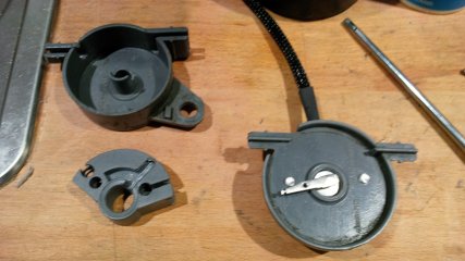

Another part I need is a TPS (throttle position sensor) for a metal throttle cable - basically a 'throttle cam' TPS.
I imagine something like this:
Where can I find such an object?
