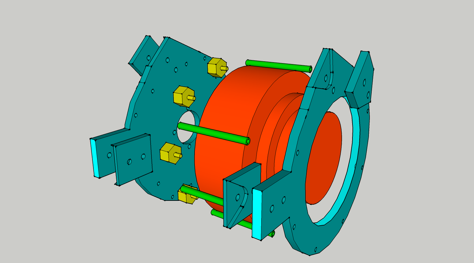

Motor Mount:
I have been learning Sketchup to model motor mount brackets. I created a cardboard model of the LEM200 to make sure it would fit in the frame, and then created the following model:

Orange - Motor
Blue - 10mm mounting plates. I'd need to get these made by someone like emachineshop or bigbluesaw. Could I use aluminum, or would steel be needed?
Yellow - Standoff spacers, I can buy the size I need from https://www.unicorpinc.com/metric-male_to_female_standoffs.htm.
Green - 100mm unthreaded spacers, I haven't found anyone that makes a 100mm spacer, but I'm sure I can find some generic pipe of the right size somewhere.
As for modeling the actual bike itself, it's beyond my current abilities. Someone on the forums here has a model made already, I sent a pm but haven't heard back yet. Does anyone know of good a free program that can turn photographs into a 3d model?
I am not an engineer and have many questions about mounting strength/requirements and would appreciate feedback. There are only four intended mounting locations on the frame. These points are within 90 degrees of each other which does not seem ideal. Is this design strong enough? If not, perhaps I could add another mounting point on the battery box on the other side, which I have yet to design.
Any thoughts, advice, feedback, critiques would be much appreciated!
