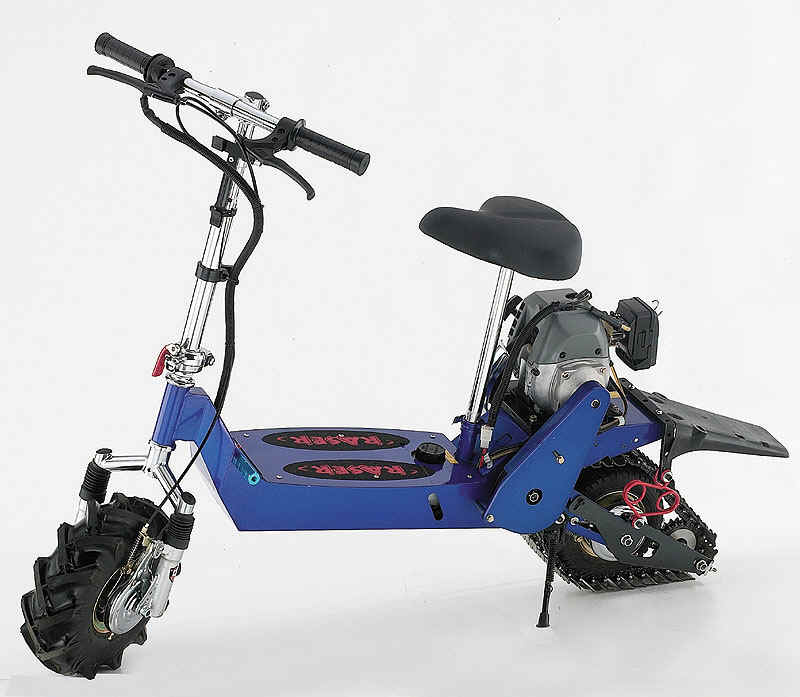

I didn't even know there were "snow scooters", that track system looks awful familiar... I saw a bolt on kit to create a snow bike somewhere here on ES. I have one of those scooters (3 actually, 1 real razer and 2 knock offs) and a GoPed (would be a better platform for a snow scooter, more power)...

I've ridden my goped in the snow and while it's horrible for traction (those tires on the snow scooter are sick!!! - wouldn't a front ski make more sense in snow - at least they should have skis mounted at the axle point so when you go from road surface plowed or packed into deeper snow... the skis allow you continued control of the front end (theoretically seamless transition).

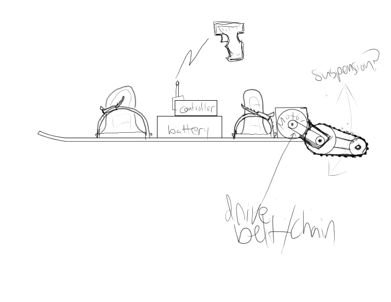

I had an idea something like that. It seems to me like you could use the weight of the batteries and other components to make a pretty well balanced ride. Since I moved to boston from the relatively snow free pacific northwest my mind has run amok with snow friendly e rides for when the bike path that runs along the charles river is completely impassable to bikes after huge snow storms. What is great about living in boston is that it is quite flat so lower power snow projects actually seem feasible.

That's close to what Im thinking... I would use a longer board to begin so my drive system should be mounted in the area just to the right of riders right foot (goofy from behind) and literally be the tail end of the deck.
Then you create a small 1-2" deck riser (just like what you would use to mount trucks to a skate board deck) and second cover, creating a space large enough to enclose the tread foot, the batteries (2-3S x P evenly distributed in the fore section of the board to offset drive unit weight).
Also... the scale on your draft is a bit large for an RC motor, I found several which have an acceptible kv range for the voltage I plan to use (aiming at 20mph top end max) and the OD is 1.5" to 2.0". - that would fit within the deck space (the tracks would protrude from the bottom about 1" or so - adjustable) so only a little hump cover would be needed over the motor / drive section and it would likely be just under your right foot location,
This gives the design more stability, stealth and with a bit of luck and trial / error (if the snow keeps up this year) and it should serve my 3 minimum requirements:
1.) Tracks must be retractable to allow normal snowboard function without drag
2.) Range: 5mi - Longest commute on this would be about 2 mi to the store when the plows can't even get out but for safety I would design with a 5mi range at WOT which should equal out to 14mi @ 12-15mph.
3.) I would hope for enough power and dig to ride up a slope or hill - not really a requirement, if I have to drag it to the top of hills though... I can attach a small lanyard to the front of the board and use the remote in my pocket to propel it up the hill as I walk.
Not too complicated - until I get into weather proofing the deck.
I'm more interested in the rear drive eBike conversion (has ski in front and large tracks in the rear) as a practical means of transport in the 12" or so we have now (it's still falling) but this just seems like a fun, cheap way to make use of our tech in a scaled down manor.
-Mike
