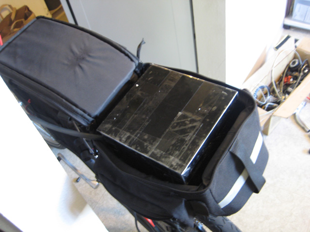

It looks like a triangle mount of this pack could be difficult. It fit within my cranks however, leaving a few MM of space. Mind you, my cranks are not bowed out at all. With a wider bottom bracket, or cranks that bow out a little, it would not be too hard to mid-mount a 36v or 48v 12ah version of this battery.
The battery fit very snugly into a topeak MTX rear bag.
With the battery charged to 41.90v ( after resting for about 15 minutes after charging ), i figured it's time to take this battery out for a spin!
