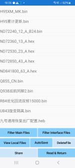

Can you please describe how to do this? Or probably you have some english manual(user guide) for firmware updates and for all the settings in the app? Really appreciated🙏
Firmware update ist not described in the manuals I had found in the internet.
I had done it with the old app version 1.3.7. It was during a live session with a technician from Siaecosys.
The new app is different, and it is over two years ago I had done this.
I don´t think I can write a good manual for it.
Why not ask your seller. If it was DUN or Siaecosys they can provide you a video how you do the update.
I think in the new software you have to press "upgrade" and then you will see a list of files from the internet or you can link to a local file, but I am not willing to try it , as my controllers are working, and never change a running system ;)
Unfortunately, the seller is from Aliexpress and in the chat it's only some sort of first level support, who gives common advices like "it's your battery fault" or sometimes asks their "engineer" and forwards the reply back to me. The most what they suggested is to adjust AN, LM parameters, for removing excessive vibration in cruise control function. Helped a little bit. But the main problem - controller suddenly becoming unresponsive - not solved. At least, if somebody could help me to make the controller restartable while wheel is rotating - it would be very good. Because its the main problem.
My sabvoton also sometimes stopped responding but re-starting it by switching ignition off/on helps. Sabvoton can restart while I'm in the middle of a road at a high speed
But fardriver is dangerous sh..t, as in case of any failure it DEMANDS me to do full stop (hard to do on a freeway). Probably there's some firmware without this annoying behavior...
If you press on upgrade and local files you get a list and down there are a few firmware.
The .hex files are the firmwares
Your phone needs to be connected to the controller and the internet.
