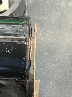

This build is on a bit of a pause.
Started welding the battery and realized I needed to figure out part placement and a case.
IMG_3903.HEIC_compressed.JPEGIMG_3905.HEIC_compressed.JPEGIMG_3911.HEIC_compressed.JPEGIMG_3910.HEIC_compressed.JPEG
These premade nickle/copper strips are as awesome as I'd hope they would be. Zero issues with them. (I ran the welds a smidge hot, but better than weak.)

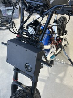

With the Harmony bms target in mind, I modeled up what that would look like and got these:
Screenshot 2025-09-10 at 10.55.14 AM.pngScreenshot 2025-09-10 at 10.55.47 AM.pngIMG_3914.HEIC_compressed.JPEG
The case would split in two, have a recessed space on the front for main discharge, a dedicate charge port, and power button. The whole thing secures together with some m5 rod and locknuts. Did a test print where I cut down the "length" of the case to see if the finger joint works, batteries fit in it, it fits in the frame, etc and came out great....on the 3rd try ;D (The hex pattern was just to save some time/filament for a test print -- it'd be a solid print in the final thing.)
