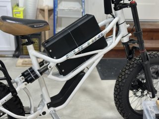

Hardcase complete.
My first attempt was to cut out a frame from HDPE and kinda sandwhich it together. The work was...fine, but turned out..poorly. I went with some "1inch thick hdpe cutting boards" off amazon so I could mill out the shape I wanted. The work on the CNC went pretty great, but I soon discovered that the price was too good to be true. Each piece displayed some incredible surface warping, and as I milled the material most of the pieces released some major internal tension and bowed/warped really badly. Ultimately, just really was not happy with how to shaped up because of my penny pinching on the source material.
So, I went back to the 'ol tried and true 3d printing. Took the CNC model, along with a (rough) 3d scan of the bike and remade a
version that would fit on a build plate (albeit, split into some pieces and epoxied back together later).
About 20 hours of printing at 100% infill, the shell was done. Apply epoxy, sink heatset inserts, and jam the battery inside. Wires were made, padding was added, whole thing is ready to rock-and-roll. Stuck it on the charger, as the cells are still brand-new and at the shipping half-charged state, and let it get up to a full charge. Took 3.5 hours, lol this thing is going to go for DAYS.
I reconfigured the Phaserunner for the higher power battery and also gave it 40A of field weakening to play with. In mid-air, the speedo now reads 40mph -- I suspect when I get it out for a test right it'll likely settle around 35, but we'll see.
The one "ugh" is that there's not really a good way to secure this to the bike, There are battery tray M5 bosses in the battery tray area, but there's no way to screw into them from "inside" the case. I'll pickup some basic straps tomorrow so I can at least hold it down, so that may have to do.
I also haven't setup a charger port yet, lol. Gotta get an xt60 split in there along with a charger ports...somewhere to accommodate. Tomorrow problems.

Honestly as long as there is a good way to prevent the battery from sliding I think straps are just fine, if you want something sleeker making custom straps can work better. I've been playing around with the best way to have a low profile strap system that can also be tensioned well. A bit more annoying to tension than using rope or fishing line though. Especially with a plastic case I trust straps, rope, fishing line more than bolts. Those you can spread out the force over a larger area and the result is much stronger.
I'm surprised there wasn't some 3D model out there of some tilt in battery mount like Reention that couldn't have just been union'ed on to the case model. Then just bolting a $12 Reention rail down would have been enough.
There very well could be! Plus, since I have the 3d scanner now, I could probably use that to get a rough and then remodel it to be precise. I think the real problem would be relying on that after a 3d printing process. Those tend to have a lot of very shallow, very sharp "catches" for the slot/slide/retain process, and that's one of those areas where the print orientation matters a LOT, and the right way to print that might not really be compatible with the way the rest of the case shell might need to be printed.
Indeed. The more I looked at how a few bolts in the bottom of this case would compare to a good strap going around the whole thing, the less appealing the bolts became. This battery is 2x the height (and weight) of a normal case, so the side-to-side rocking motion would put way more stress on bottom held bolts or the battery tray style setup.
Ultimately, I popped over to the store and picked up the cheapest (200lb capacity, lol) straps and just wrenched it down. Two across the top and one across the front pulling it tight in every direction. I gave it a good slap and a "that's not goin' nowhere" so it's all sorted!
