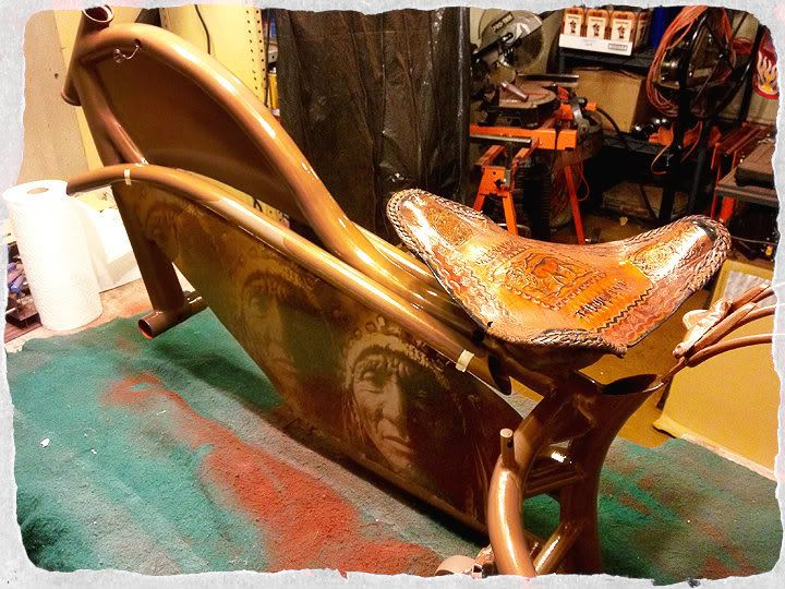

I Started the battery cover side panels. The top photo is closest to the actual color. My overhead lights scream with 1000 watts like an operating table which makes it hard to take a true visual pic. Im working on getting the correct shape on my graphics. I have my graphics temp taped to the frame.
Then they will be mounted behind lexan clear to give them a high gloss look while looking through the lexan. Finally they will sandwich 4 SLA batteries. (48v) with my own mounting tech. I can't afford 550.00 batt's so I'll be towing around the extra weight.
I picked up some lexan clear for the battery cover side panels.
I cut both sides to fit the shape of the frame. I adhered the
graphics to the inside of the lexan which gives it a high gloss
sheen when looking through the clear. It is so shinny that it's
hard to take a good photo with everything reflecting into it. Even
my ugly mug made its way into a shot. :rolleyes4:
I set a few pieces of the body together to take a look. It got me
excited for the reassembly process.

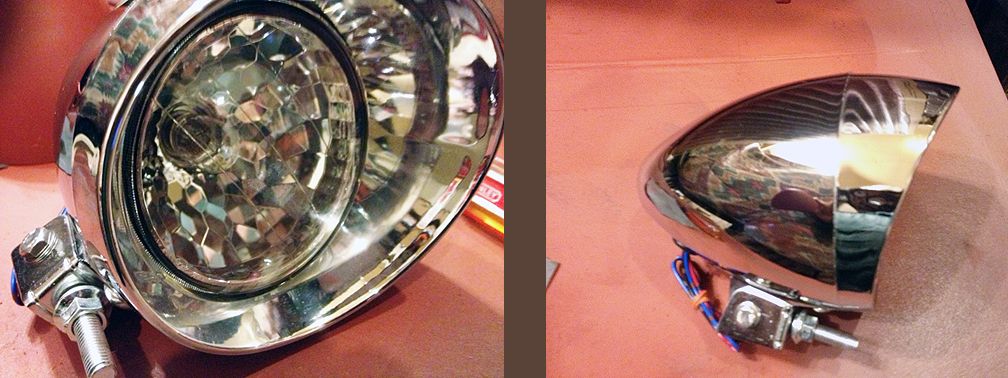

I took an old motorcycle headlight off the shelf and tore it down and made a 200lm
flashlight-bike light conversion. This little baby is as bright as a car light.
Orig Light
Light tore down with Cree P4 chip CR123A Flashlight
Paint time, and drilled out the old
wire entrance to allow finger on and off switch
Finished. Let the light scream
Lets find our way home

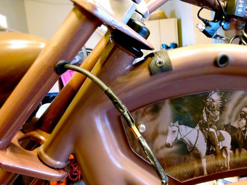

Time to do the wiring for the 48 volt front hub. I had to chop the wiring in half to get the manufactured plug ends through the frame.
I'm trying to hide as much wiring as possible.
The first shots are.... the front wheel with the hidden 48V motor sandwiched between wheel covers.
Vents were added for cooling. Currently I will only get approx 12 miles out of the current batts. All of my tests
indicate the motor running cool at this distance.
You can see the Wiring sneaking out from the axle.
I used some weed whacker line to fish the wires through the fork. There are many
different things to use to pull wire buy I haven't tried trimmer line before. (worked great)
Pulling the line up through from the bottom.
Fishing the line through the top of the fork.
Success.... that was super easy. (this time)
Continuing it through the main top tube.
Exiting through the 48v battery compartment area
