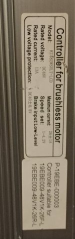

These are images of battery and charger labels

42v would be correct for a 36v (10s) battery. If the charger can run the motor, it sounds good (at least the 36v one)
Many chargers have a safety feature that will prevent output until it "sees" battery voltage.
You could try measuring the voltage across the charge connector on the pack.
If the controller lights up when the 48v charger is connected but not when it is disconnected, it points to something in the pack, like a bad cell. You may need to take apart the battery to measure individual cell voltages to tell.
The 48V charger should be at 54.6 volts open circuit. If you only have 15, it's busted. WHen your bike runs off charger, you mean the 36V charger?
The 36V charger should be at 42.0 volts open circuit. Connected to your battery, it is correct that it stops at 42 volts.
Your new controller probably has its low voltage trigger right around 41-42 volts. I recall that my BBS02 mid drive kit, set for 48V battery will trigger a low voltage alarm if I connect a fully charged 36V battery. Tapping the throttle shuts it down. So I am not surprised that your relatively simple 1000W kit does what it does.
Try another 48V charger.
