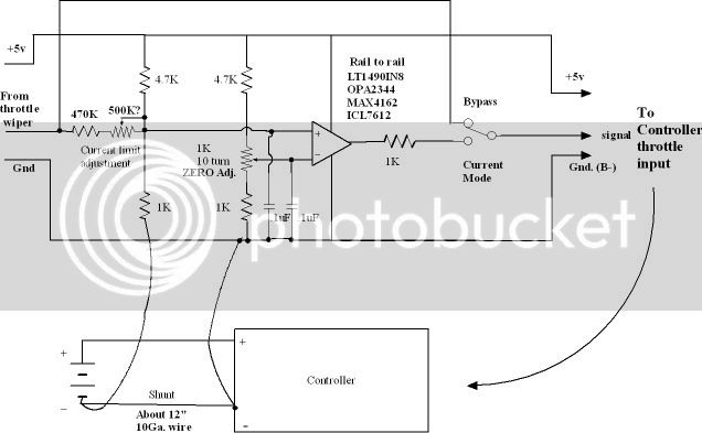

OK, so a standard ebike accelerator ajusts to a speed, and the difference from this speed ajusts amps. So you could say it's a speed based throttle.
Well from the voltage forums I'd saved this pic. It shows a circuit that should allow the accelerator to be amp based. So, for example if you crack open the accelerator ro say 10 amps, then it's gonna try & hold 10amps for all it's got. So if you're rolling at part throttle pushing 5 amps you'll be going at a given speed. Hit a hill and it's going to slow down, stil burning 5 amps. Go down a hill and it's going to keep burning 5amps untill the speed is too high and the controller can no longer put out that many amps.
So it's more like a gas motor's accelerator, where you play on force to get your speed, rather then the other way around. The consequence is that it should be easier to go gentle on the batteries, especially if you've got lots of stop & go or hills.
Ok, so this thing has a pot to ajust the accelerator's zero, as I had done back when I had a throttle. But the part that's especially interesting to me is that it has a pot to ajust max amps. Since I've circumvented my controller's amp limiting capabilities, it's the batteries limiting the amps. So the idea is to use this circuit to limit my controller below 60amps, with a 60a fuse. This way I should be able to use better batteries without blowing the fuses all the time.
So before I dive into this, anyone see a reason why it wouldn't do the job at limiting amps? (I don't intend to put the bypass)
