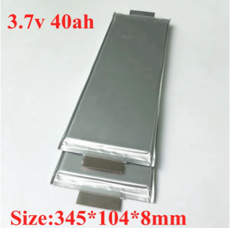

Feedback for ebike battery build: 20s 40ah lithium polymer pouch
owhite
Aug 3, 2020
290
High Capacity Li-ion Battery 3.7v 40ah Li Polymer Battery
Battery Type: Li-polymer
Nominal Capacity: 40Ah
Nominal Voltage: 3.7v
Dimension: 8x104x345mm
Weight: 650gm
Internal Resistance: ~1mohms
Discharge rate: 5C 200A
Max discharge rate: 8C 320A
Cost: $40 USD
Does anyone have an opinion about the downsides of using these batteries to build a 20S1P, 72v pack that would deliver 40Ah, 200A continuous discharge? Comments would be quite welcome. I have a lot of experience with power electronics for other (non-ebike battery pack) projects and I'm not worried about the completing the build, so other than cost I dont see a lot of downside. I'm planning on running a QS205, and have yet to purchase the controller
what's not to like!?
Owen
Link and picture included below.
https://www.aliexpress.com/item/329...0.0&pvid=c2850760-28f2-4b3e-9d4c-5ce274767516

This size of low C rate pouch cells are usually crap. I’d say 50% chances, if you are a gambler. :wink:
