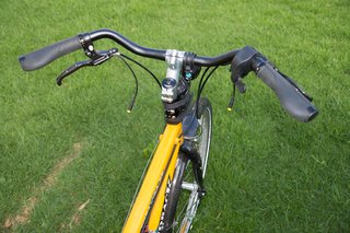

I looked for a steel frame with a 1 1/8 head tube and found this DiamondBack frame on Trade Me (NZ local auction site).

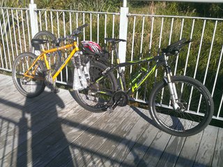

I took it the 8.5km to home by removing it's front wheel and tying it to the pannier rack of my mountain bike. I did this again (second photo) after I lent it to a friend for a week.

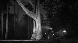

It was pouring with rain while taking these photos. It creates a nice effect with the beam of light.

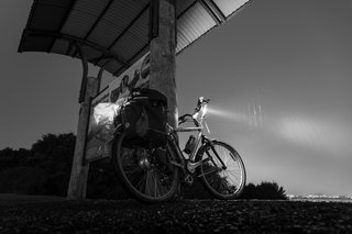

A break in the rain while shopping
