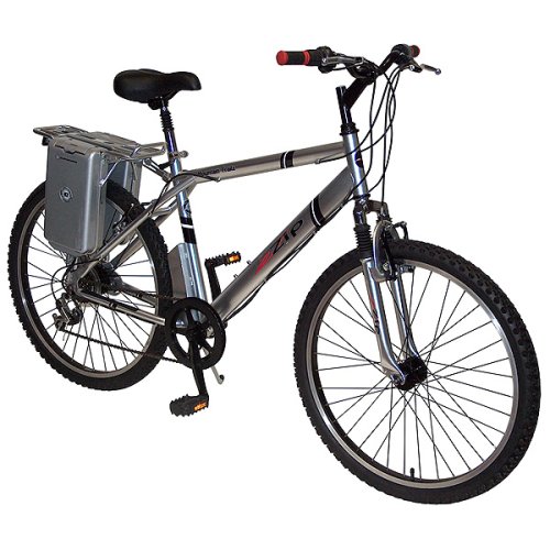

Here is a stock photo of my bike
a lot of the other bikes like mine that i have seen here have the controller between the batteries, and mine is below the seat post does this mean its a 2007 model?

That's how I found this site too. I just recently completed my speedier mod. There is abundant evidence on this board that the ezip controllers and motors can take 36V without too much trouble (a least as far as we know in the short term). Thus, the simple answer to more speed is to wire a 36V battery to your free battery connector. If you unscrew the two-pronged socket on the bike, there are just a couple of ring tongues at the ends of wires that are connected to the pronges with screws. Thus, it's easy to wire in your own battery connection by putting a couple more fork or ring tongues around the same screws. I made a 36V pack by putting three 12V SLA 7Ah batteries in series (with a 30A automotive fuse to be paranoid) and wiring the poles into a female XLR connector. That way I can use a 36V scooter charger with an male XLR connector to charge my new battery. I wired another male XLR connector to my ezip to connect (and disconnect) the new battery. I found everything I needed on ebay or the local hardware store. I've been using my new battery for a couple weeks and everything seems to be holding up well.
