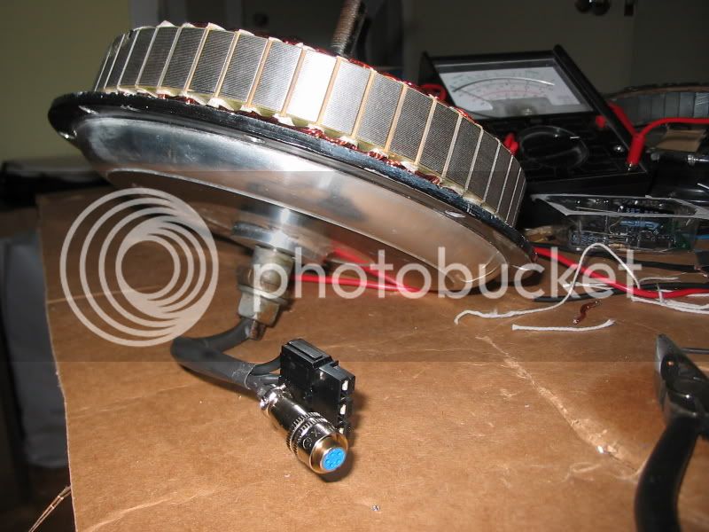

It would appear the biggest I can fit into my motor's axle is AWG16. So be it.
It's bigger then the stock cable was anyways. The hall sensor wires were
made to fit by squeezing them into the gaps between the cables, I plan to
cover this mess with heat shrink tube and then pull it into the axle as far as
it'll go, so it should look like one cable from the motor onto the
connectors. Good plan?

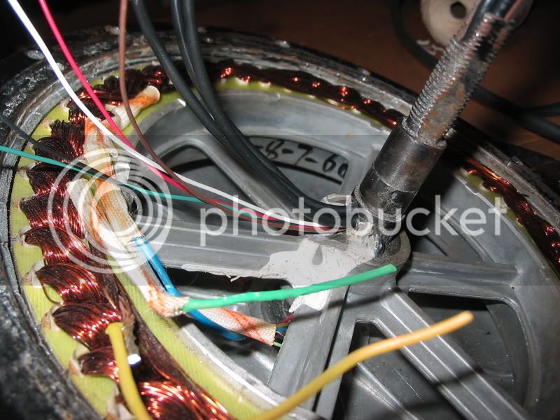

How should I connect these cables to the motor coils?
I'm thinking lead-free solder and a peice of heat shrink tubing.
What I see is that the original wire is twisted/soldered into a buncha coil
wires that apparently got the insulation scratched off of 'em, and this is
covered with a cylindrical cloth insulator that's covered with transparent
plastic. I could prolly the new cable fit into this original insulator.
Twist, solder, and heatshrink should be good.

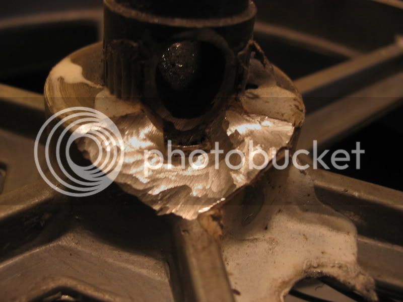

OK, I keep ruining the wires. I can fit'em in using lots of lube, but they keep stripping the insulation at the bend when being pulled/pushed through. Maybe I'll whip out the angle grinder to make the bend less sharp.

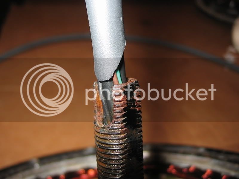

3 AWG16, the five small strands are distributed between the openings:
Just barely fits at all
Trouble at the other end

Angle grinder for the most part and finished with the dremel. Hella sloppy
workmanship because I couldn't find my glasses - so I had to grind with
my eyes closed, stop grinding, look, close eyes, grind some more...

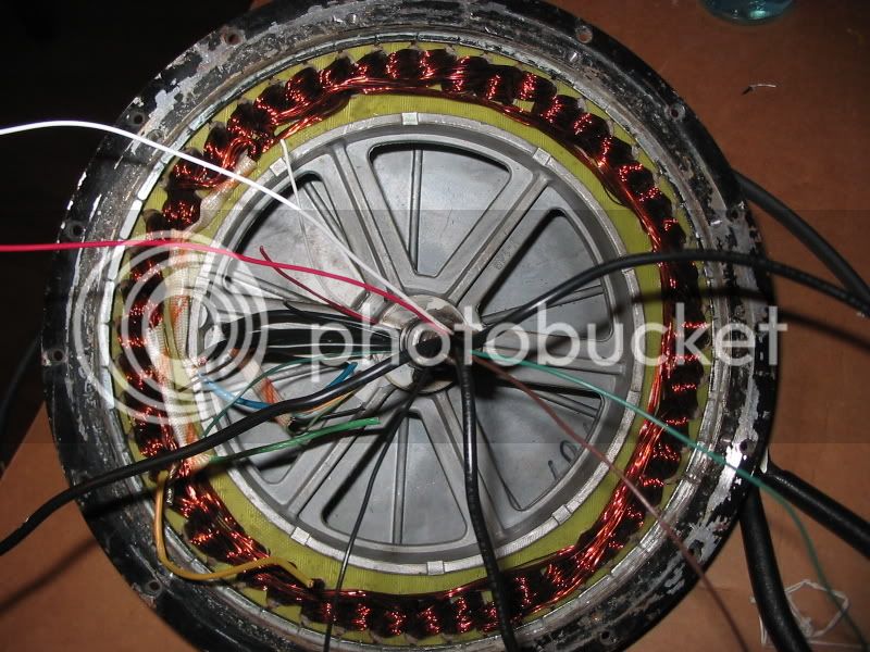

EditII: Success!
Here's what you do: Start by fitting the phat cables in 1st, make shure they're all at the right length and there's a hole on the outer bend side cause that's where the hall cables are gonna go. If it's tight, you can push/pull them back and forward to get the third one through. The hall wires are very thin & bendy, so you can't put them on top easily. Slip one at a time in so it touches the outer bend part, and it ought to come out the other end. The last ones are hard to fit, but you can pull the 3-4 hall wires already in without damaging them, then adjust the lengths once they've peeped through. Don't try & pull the coil cables back & forth at this stage, it's be real hard and you'll strip the insulation off at the bend.
