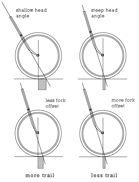

Almost forgot, this will be a 26" wheel commuting cruiser, not a sport-bike, a recumbent site recommended a 62-65 degree head tube angle for a stable ride, thoughts?

Its a pretty 'aggressive' head angle its near to what i have used (~65 degrees) on the last two frames i have made, not sure how it
would go on a short wheel based bike perhaps Hal would have better idea i believe he made a frame for himself
with increased head angle to the rest he produced IIRC? Whatever you go with make sure the trail is adequate
or it will have a heap of flop making it potentially dangerous to ride...best of luck with it mate look forward
to see what you come up with :)
KiM
p.s if increasing the length of the wheelbase is an option, this will add to high speed stability also.

For the head tube angle vs stable ride, it partly depends on speed. The faster you intend to ride it, the shallower the angle can be and remain stable.
For instance, my CrazyBike2 has a shallower angle than my road bike, and it gets *more* stable at much faster speeds (approaching 40MPH downhill it is like magic!), while the road bike gets *less* stable at faster speeds but is more stable at lower ones. Part of that is other frame geometry and rider height, etc, but part of it is definitely the head tube angle.
Early this year, I tried an experiment (which I need to someday get around to documenting on my blog) before I motorized CB2 where I put a 20" wheel on the front* and a 26" on the back, and coasted down the same hill I had previously done on both 24" wheels. The change in tire sizes made the head tube angle steeper, closer to the road bike's, and it performed less well in straight-line steering stability at the higher speeds, as the road bike did (although still much much better than the road bike, probably because of the rest of the frame design and profile). It felt jittery as I passed 25-30MPH, and I really didn't like it much at 40MPH. Not as scary by far as the road bike, but still not as much fun.
On the other hand, it was more stable at slower speeds; easier to keep going in a straight line without as much side-to-side flopping around, with the steeper angle.
I don't think I've ever measured either angle, but you could probably determine it from the side-view pics I have of CB2 on this site and on my project blog.
*Note that my 24" front suspension fork was modified for an earlier recumbent I never finished, so that it would take either a 24" or a 20" wheel and still have working brakes, by welding some rear dropout tabs to the front edges of the steel suspension tubes.
Some info about doing that is partway down this post:
http://electricle.blogspot.com/2008/09/pics-of-parts-and-progress.html
When I used *that* fork for this test, it was about as stable with either wheel size.
When I used a 20" suspension fork for this test, I got the results described.

Assuming your builds are typical uprights, then I suggest you stick with well established head tube angles - 72-75 degrees. Head tube angles outside the aforementioned range will invoke difficulties in finding forks with the correct offset (rake). For example; Assuming a head tube angle of 73 degrees, a wheel Radius of 13" and a typical fork offset (rake) of 1.5", will produce 2.4" of trail. With your purposed HT angle of, say 63.5 degrees in combination with typical, off-the-shelf fork offsets of 1.5" and the same 13" wheel radius wheel, your trail will be double at 4.8" - resulting in massive fork 'flop'. The only fix in this case would be to build custom forks or plan on bending the existing blades to eliminate the excessive trail.
