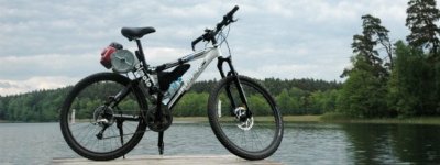

http://www.bimoto.pl/index.php?s=34&l=en
Something like eLation but more sophisticated (as I was told). Two freewheels inside. If you are pedalling the motor chain does not move (lower drag). It was originally designed for Honda engines. Now it works with Cyclone motors. Looks OK.
