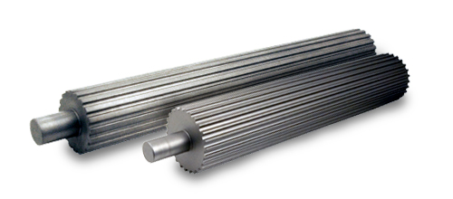

I'd like to copy this drive, the big hold-up for me (and others who are also interested) seems to be the difficult-to-source EV-Warrior roller.
There HAS to be a way to copy the freewheeling one-way clutch-bearing and drive-roller by finding compatible generic parts! Since the roller touching the tire is a vital part of how the drive functions (but easily freewheeling at idle with no drag), this is the missing link. Once the motor is energized, the roller pulls itself deeper onto the tire tread.
CSK-PP one-way clutch-bearings have a keyway on both the ID and OD, so if its possible to use them (in their available sizes), there would be no slippage between the shaft and roller. I'd also very much like to find a combination of parts that would allow a removable sleeve to be used over the roller. Certainly not a requirement, but a very desireable addition if possible.

I'm going to go ahead and take one of my rollers apart and post pictures of it. There doesn't seem to be much to them. Just the roller, a couple of brass bearings, the clutch bearing, and the hardened shaft. I think the bearings are pressed into the roller without a keyway. I've always wondered how they made it so the clutch bearing doesn't slip under load. It must be a very tight fit or I'm missing something.

Sorry I haven't posted photos up yet. I've been swamped with work for the past few days. I'm going to try to take one of my rollers apart tomorrow. I don't think they use key ways though. It's just a smooth hardened shaft and the bearing seems to be a press fit. In fact, I hope my little press can get them out of there. I actually did a little research at one time for the same kind of bearing and they were kind of expensive. I know the ev warrior rollers at the time were less than the bearing by itself.
Ok... I just tried to press the bearings out. Man, they are TIGHT! I'm going to see if I know anyone with a bigger press. Now I'm wondering if the brass bushings inside the roller have a different outer diameter than the bearing. The bushings move pretty easy but as soon as they get to the bearing it stops dead.

Compared to any I've seen on the 'net the one in the EV Warrior roller looks like it has a lot more needle bearings in it. They're tough for sure. I really thought after I switched to an outrunner that it would just screw the bearing up and make it slip or something.
I'm really hoping to press one out so I can get some pictures taken.

So far I've found very expensive parts that would allow us to copy the EV-Warrior roller, but I'm still looking for HTD pulleys that can attach to a 15mm shaft. I want the direct-drive motor option just like your set-up, Todd. But also, I want it easily adaptable to a single belt-reduction with a motor that sits on top.
Matt used 1/2" on all his drives, and he even made a freewheel adapter to slide onto a 1/2" shaft (Staton makes one in 5/8"). I'm guessing the 1/2" shafts gave him lots of choices concerning pulleys and sprockets. It would be great if we could find 1/2" shaft parts. The IDs of thick-wall aluminum tube would be a pain to get turned, but shaving the OD's would be fast easy and cheap (if needed).

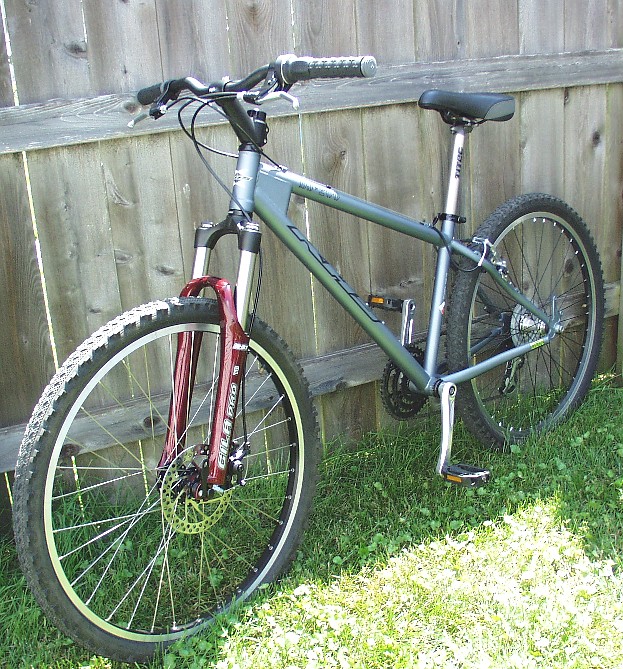

I finally got my DJ bike put together today.
After riding my father's comfort bike I realized I'm getting older because I kind of enjoyed it. It helped me decide to make a "comfort dj bike" hopefully without making it look too dorky in the process. I'm just sick of riding a bike all hunched over. It's soooo nice being in a more upright position. It's not as good for hill climbing but that's what the motor is for (even though it's not on it yet).
I had a great time this evening. I hit some local trails just to see what would come loose on the bike. So far so good. DJ bikes really do feel like a bigger BMX bike. I like it. I'll get some pictures of it this weekend.

Quick picture of the new bike:
I know, I know, RST forks suck. I got this set brand new for $13 so I couldn't pass them up. They actually feel great to me compared to the old rock shox on my Raleigh with almost no travel. I think they'll be just fine for road use. Ignore the pedals and cranks too. I'm putting Race Face DH cranks and Kona pedals on it soon.
I hope to get the motor slapped on it this weekend for a little test run.
