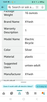

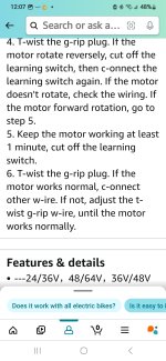

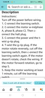

I bought a brand new 350 W controller for my 250.Watt motor. When I tested it, it was going in reverse.I hooked up the learning wires connected them.It's started going forward. I disconnected them took it for a test ride. It was jerking and making a bunch of noises until it got up it's to full speed and then it Smooth out and was normal, slow down again.Did the same thing. I was trying different combinations with phase wires With no difference even worse so I ended up putting it in reverse and hooking The learning wires Reverse that back to forward now.It goes to speed of reverse in forward Direction. with no noises and no jerking. I learned to ground the blue and groundwire "blk" for the three Position switch to have ir run at 120%. I cut that grounded WI. Don't use the 3 position. Switch at all, but it's still going forward at reverse speed. And I have the reverse button on but I made it go forward with the learning switch. Why is it making noises when it can still go full throttle the other way? I hope I'm saying this right This is my 2nd full day trying to figure this out.I'm asking you guys which I should have done in the beginning.Maybe I should have read this better the directions.I don't know what I'm missing.Thanks for your help
