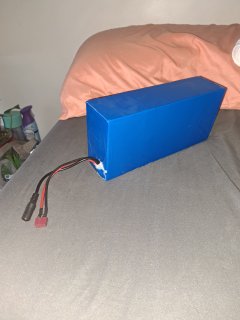

I ordered a 48v, 50Ah, 50amp BMS e-bike battery on AliExpress. I wrote down dimensions and ordered a battery bag that would fit. It was supposed to come with a charger with delivery date 11 days away. I paid $153 for it including tax and shipping. No charger came so I had to buy one. The battery that came a month later was much, much smaller than the original dimensions. The wires coming out of the battery were so small and thin, I knew they were not thick enough to safely to handle 48v at 50amps. I complained to the vendor who stood by their specs. When I charged the battery and connected it to a 48v 50amp boat motor, it registered over 50v but as soon as I applied throttle the battery's tripped it off immediately. My money has been refunded but they don't want the battery back. My question is there a way to find out what I really got? Amp hours, how much continuous discharge it can handle? I hate to just throw it away. I own a multimeter and bought an energy meter for another battery.

Open it.I assume it is shrink wrapped.I have a few &they have fiberglass panels taped to make a box then shrink wrapped.A 50ah battery would weight 20 pounds at least
It weighs 9 pounds is 9 and 3/4 inches long instead of 15 inches

That's about 1/4 to 1/3 of what I'd expect for a 48v 50Ah pack.
I use a 52v 40Ah pack, and it's around 35lbs bare cells, and is roughly a foot by a foot by 3/4 of a foot. Good cells of more modern technologies could deliver more capacity in a smaller lighter package, but not by *that* much.
Based on typical too-cheap-to-be-true packs we've seen before, it's highly unlikely that good modern cells were used to build your pack; it's much more likely that it's made of recycled garbage cells salvaged from dead or failed batteries, and may even be random cells rather than all the same kind. Probably is also untested, so that the cells are not matched to each other and are unlikely to perform well together as a pack.

Give all the LxWxH dimensions, not just the length and one can figure out how many cells you have.
It sounds like 18650 cells. One cell is 18mm or .71 inch. A 48V battery is made using strings of 13 cells in a row, and that's 9.2 inches if the cells were stacked tight. Can't be 21700 cells as 13 of those is over 11 inches long,
The height is 65mm or about 3 inches high, right?. Give the width and we'll know whether it;s 13x3 (2.2 inches), 13x4 (2.9 inches) , 13x5 (3.6 inches) or 13x6 (4.4 inches). The weight of 9 pounds suggests 13x6. to me. Probably 10-12AH then using 2AH cells.
That's 78 cells for under $150, When cells cost less than a dollar, they're pretty bad, Like amberwolf says, do you really want that charging under your roof?

Cross checking, a typical 18650 cell weighs 50 grams, so doing the math with 78 cells, that’s 3900 grams or 8.7 lbs for the cells, so 9lbs with BMS and hardware sounds about right. I agree, junk cells.

It also means between 9 and 13Ah for typical new nameless Chinese generic cells. If they're recycled or salvaged, they could have a little more capacity or a whole lot less.
Here are the exact dimensions and photos: 10-inch long, by 4.5-inches tall, by 2.74-inches tall. It natively has a T connector and a charging port
