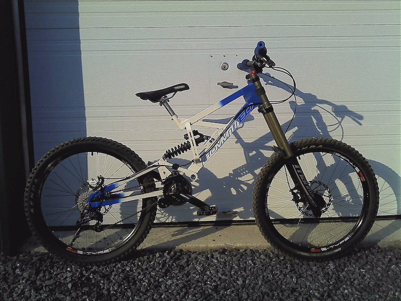

for sale on pinkbike, no triangle but 11" rear travel :p , homemade, of what metal i wonder - gotta be alum, right?:
or suggest some frame alterations (to a local welder)... rough idea...
nah ive seen this guy's bikes on another forum, hes reportedly good at what he does but im pretty sure that bike'll be cromo. I'd even ask if he could cut out the bottom downtube and install a oversized one that'll fit some batts inside! otherwise welding a few tabs to it will work too...
edit
http://www.pinkbike.com/forum/listcomments/?threadid=39840&pagenum=91
he's not on that page, but he's got a number of posts in that huge thread.
