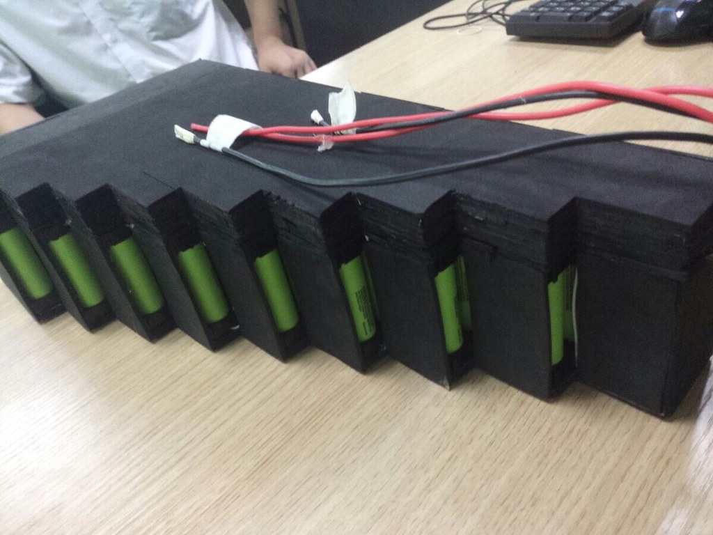

Here are pics:
Bike by Jeff States, on Flickr
Keep in mind, the wires coming from the BMS are 14gauge I believe, they are not 12gauge.
Testing:
Untitled by Jeff States, on Flickr
One other problem, I can't seem to get the battery to charge. I know the charger works, have verified it, is 60-75V and 4.52A.
I am leaning towards a bad BMS. What do you think? Appreciate any and all help!
