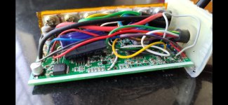

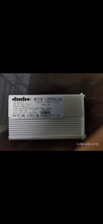

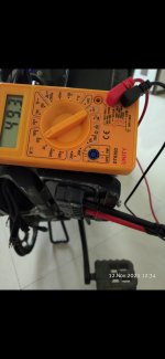

Hi guys,
I'm new here. I have a 48v 250W bldc hub motor that stops working as soon as the voltage goes below 50V. If I charge my battery to full, it works perfectly alright ultill the battery reaches 50v or below. The battery power bars in the display starts fluctuating and the motor rarely gets any power.
I did check my charger voltage. Its isn't fluctuating nor my battery voltage is fluctuating. I did reset my BMS Too to see if this was a battery issue? But the issue remains the same.
I have a DMHC controller with TC480 Display that allows me to change the 24/36/48V. When I switch to 36V the bike again works on very minimum power. If I use acceleration the bike gradually picks up with very less power.
I'm totally clueless as to what is going on. I'm mostly assuming it's the controller which is at fault. The LVC ( Low voltage cutoff) for some reason has gone high suddenly. My bike was working fine untill last week when I tried to install a new ebike light but the 12V line had no power in it. The 12V line gets power only for 1 sec and them goes off. Can anyone help me with this. I'm attaching few photos for a better overview of the issue. Any help would be appreciated.
Thanks in advance

Without more details on what bike light was hooked up and how, I can make a guess:
If the light was a 12v light that draws more than a few mA (very likely) then it probably damaged the 12v converter inside the controller.
That is usually an LM7812 or equivalent, or it is a LM317 or equivalent, or it is a small SMPS (switched mode power supply) made of numerous small parts.
If it is either the 7812 or 317, simply replacing that part will likely fix it.
If it is a controller that uses a large resistor on the input to that 12v converter section to drop voltage from battery pack to whatever the converter can take, the resistor may be damaged (may look burned or darkened in the middle). You might have to replace those, too, if they don't read with a few percent of the resistance marked on them.
If the converter (or resistor) is damaged then they may not work correctly when the voltage drops below some point (which depends on the damage).
It's unlikely that the 5v converter that runs from the 12v was damaged, but if you still have problems after fixing the 12v, then you may have to replace the 5v converter too. It is usually an LM7805 or equivalent.

Thank you for your reply.
I was hooking up a 12v light and also tried to put up a 12v horn to it. Nothing worked! So i stopped using that line now.
I did check LM713, it's working fine untill 49V. As soon as I touch 49V the supply to LM317 shows 39V which i noticed yesterday! I think it's either 317 or some component before 317. Should i change lm317 and see if that helps?
I also checked the 78M05 for 5V line.. That is also working fine.
I did change the resistor and now I'm getting full 54v(fully charged battery) supply on my bike light wire(I don't use ebike light tho)
I tested all 5v and 12v line. All working perfectly alright.
If you actually put more than about 36v directly to most versions of the LM317, it will damage it. That's why it has the big resistor between it's input and the battery--to drop the battery voltage down to something the LM317 can handle.
There may be other parts between the 317 and battery voltage, but it is usually just that huge resistor. If you draw out the parts and wires between the battery and the 317, you can see the path, and make sure you test all the parts involved.
There are versions that handle up to 40v or even 60v
https://www.ti.com/product/LM317
and may be even higher voltage versions. So when you replace yours, make sure you either just get the highest voltage version you can, or get the exact version already in your controller. If you already have a higher voltage version and use a lower one, it may fail under normal use because of the controller's design needing a better one.
