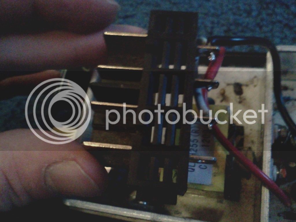

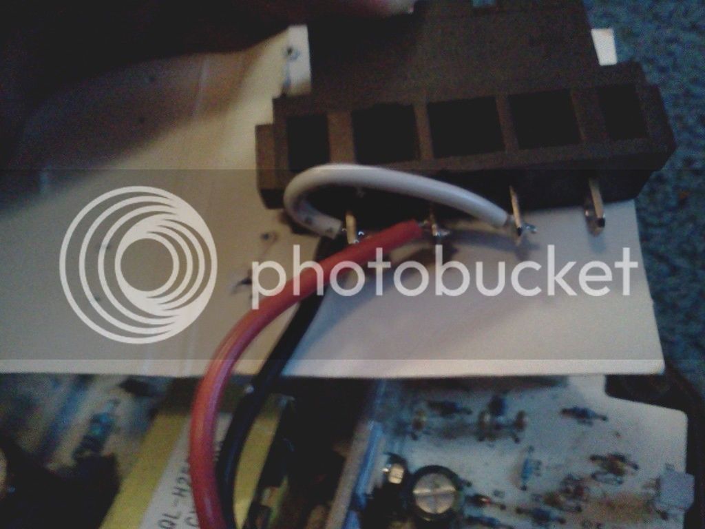

is for those that have a greenworks tool what connections are connected to get full voltage from the pack?
for instance for charging the wiring is like this:
The most I can get on my volt-meter is 31v if I go positive and then to either middle connector on the battery.
On the G-Max batteries I have, I can get the full 40v just going + to - (outsides)
Anyone know what the configuration is on the older packs?
