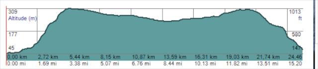

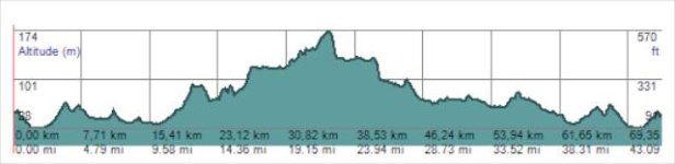

I've been reading and reading and reading... and learning some, have narrowed things down some, but still need some help. I'm looking to build a pedal assist system with the CA3, and a torque sensing bottom bracket to go on a fully suspended trike. I need it to take a 9 gear freewheel or cassette, and I understand that the Q100, Mac 500W, and the Bafang 36v/500W CST will all do one or the other. I am a women in my mid-50s, in decent shape. Seems that my situation is different than many here, I weigh a lot less than most of you, I always pedal, but I need both hill ability and speed. Performance needs are:
  • Weight of trike and rider: 180lbs w/o motor, battery etc. Probably another 5-10lbs of stuff
    Provide some assist up to 17MPH on flat windless terrain w/moderate pedaling
    Provide some assist up to 25-26MPH with moderate pedaling on slight downhill/tailwind
    Able provide some assist and handle a speed of 5-10 mph on a 6% climb for 3 miles, after that it is rolling terrain for the remaining 10-20 miles of that ride.
    Normal Range would be 15-35 miles, with perhaps a spare battery for longer rides. Today's ride was 45 miles, but that was about the longest I think we'll be doing anymore. 15-30 miles is more likely.
I'm attracted to the light weight, stealth look of the Q100.. Just when I rule it out because I don't think it will handle the climb, I see a post making me think that maybe it could. Maybe someone with real world experience with this motor can shed some light. If I'm understanding all of this right, the 328RPM version @48V with the right controller would handle the speed requirements, but would probably burn out going 5-8MPH 6% grade, even with me pedaling? The slower 201RPM version might handle the hills, but not the top end speed I need, even at 48v? If that is the case, then it seems that I will have to go to the MAC or the Bafang. If the Q100 would handle the 3 mile hill, another option would be a dual setup. Get the Q100 for all those regular rides of 15-30mi. if it could handle the 3 mile 6% grade (or maybe the new Q140 which takes a cassette).. and get the Bafang which I could equip with the same cassette, and swap out the wheel when I need more umphf. How does the Cycle Analyst play into all of this? If it is controlling the output to provide the needed assist, would that allow the Q100 to handle the hill? I would surely appreciate any help I can get... I am frankly getting a little burned out and ready to just order a MAC kit from EM3EV, and would probably have done so if I didn't think the Q100 was so damm cool. Profiles of a couple of our rides below. Thanks in advance for any advice you can offer.

6% is not particularly a problem. But most hubmotors will hate doing it at 5 mph. If you plan to ride that slow, you want a very slow winding. Mac 12 t for example. A "normal" winding needs to stay well above 10 mph, generally 15 mph minimum climbing hills or they overheat. The same pedaling effort you use to go 5-6 mph up 6% generally does the trick to keep up the speed on 6%. Just wait for your friends at the top, then continue. Once back on the flatter, or less steep rolling terrain, you can ride slower no problem. It's just a problem to go too slow up hills at max throttle.

    Any set up that gives me the speed I need on the flats is going to be unhappy going 5mph up a hill
    An over-volted slower wind will handle 8-12mph, and help w/top end, but may not get me the top end that I am looking for
What about short periods of time at the slower speeds... i.e. rolling terrain? Looking at the stats from our ride yesterday, most of it was above 10mph, average speed was 15mph over 45 miles. On that ride there are just a few short sections that slow down.. but I guess that keeping up the speed and waiting for hubby in that situation isn't a problem. The whole idea of this has been to ride with my husband, who is also riding a trike... hence the 5-6MPH on the steepest sections of the long hills.. I guess if I have to choose, I'll take speed over the hills. First, seems that nothing in a geared hub motor is going to handle 5-6mph for any extended time anyway, so that leaves me riding to the top and waiting for him, or letting him head out first and I catch up. I guess I am leaning to a MAC setup.. it's seems more complete/plug/play, I can get the CA3 there, lots of choices in the winds and controller... I don't see a kit at BMS that uses the Bafang CST...
