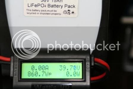

Thought I'd share this with you since you mentioned you didn't have a CA or WU meter.
I have the same kit as you purchased as a WE-BL36, but as HTB Terry has mentioned, it is the same kit. I installed a WU meter as I really NEED TO KNOW whats UP :D
Anyhow, here are some pics taken after a typical run to gym, walfart, and home... So. OC California, lots of rolling hills... My route has some 10~12% sections and alot of 4-7% on the way home as I mentioned in another thread. About 12miles total today.
I pushed the motor pretty hard to get these #'s, not to the point of stalling, but I think to the limit of the controller. 8)

Okay, I'll be the first one to appear stupid. Just exactly what are we looking at and what does it mean? Is it good? Is it bad? Does it mean you have plenty of juice left? Or is the battery almost completely discharged?
Expiring minds want to know!
Haha, well, I guess I was attempting to show what, I myself, was curious about before I purchased this kit... this shows the "real world" performance instead of the Big Bold numbers on the websites. For example this kit is listed by WE as a "500W motor with a 750Wpeak"... so I was interested to see that I pulled over 800Wp (peak watts) on the first easy hill! Also, I've seen this kit advertised in the past with a 50amp controller, then a 30amp, then it was said to be limited to 20amp, so I now know that it really draws about 23amps max. So, on the hardest hill I was drawing about 23amps at about 37volts, for 860 watts...
The numbers pictured are peak Watts, Amps, and Min. Voltage during my ride today, which is a typical ride for me.
I only used ~4.5ah on this ride, but that is because of my particular setup, terrain, weight, pedaling effort, etc. so i didn't include that. Hope this helps.
I thought anyone looking to purchase this kit would find these numbers interesting... :wink: 8)
Edit: This also tells me that Lithium batteries kick azz...

Thanks, I don't think we need to get data on every ride to know it's a 20 amp controller. Your amp numbers are pretty close to what I saw on a test with the 5 buck car ampmeter. Stalling the motor, I still never saw above 25 amps. That's good to know if your battery is a 2c cell, or worse, a 1 c cell like my ping v1. But with a real 2c cell, a 10 amp battery would be fine for a lot of folks who don't want to ride 29 miles a day like I do. I think the claims from WE about a 50 amp controller were pure marketing guys. "20 miles on sla's at 20 mph," riiiiiiight.
The real capabilities of this aotema motor are nice enough for me, with no fudging.
My intention was just to share the numbers I got with a new meter, thought people might find it interesting... apparently, not so much. :oops:
Terry, I have over 10 cycles on the battery, and this example ride, only pulled less that 5ah out so I think I am on the right track?

It's good to get actual data for this motor. I'd be interested in hard data for questions like these:
What is the no-load current?
Top speed and current at that speed?
What is the current on the flats/no wind at 17mph (For comparison to mine at 5.5A) or 20mph (common cruise?).
How many Wh/mile are you using say for a ride at normal bike speeds (14-18mph) with moderate pedaling and when going gonzo with little pedaling?
-R
I have a GPS that I use on my other bikes, so that will not show us unloaded speed, it draws a little over 2amps unloaded.
I can tell you I get an easy 25~26mph on the flats with 26"x 2" big apple tire, 28 with pedaling as fast as I can, and maintain 16-20+mph up my normal grades, usually 6-10% max. with decent pedal assistance... I really don't ride without pedaling using the motor only, as it just feels wrong for some reason. I still ride it like a bike, but am able to ride more errands and stuff without destroying my knees.
Additional data will have to wait till I handlebar mount the WU meter. Again, this was just some supplemental data to add to the original review which was quite thorough and spot on... In my case, I learned what MY bike would do, and also that the WE kit, and the HTB kits are essentially the same.
Hope this helps... carry on :)

On the contrary, it was fascinating. The only problem was I had no idea what I was looking at! I get it now. p stands for peak and m stands for minimum. Thank you very much.
It's also very encouraging. I plan to purchase an electric motor and battery for my Gold Rush recumbent. It will be a summer project for next semester. So far, I'm favoring an eZee geared motor from ebikes.ca with a ping 48-volt, 20-amp hour battery. I have a 20-mile one-way commute with a killer two-mile hill at the very end of the commute. It used to take me only about 1 1/2 hours -- now it takes over 2 hours. (I'm not worried about how long it takes me to get home.)
