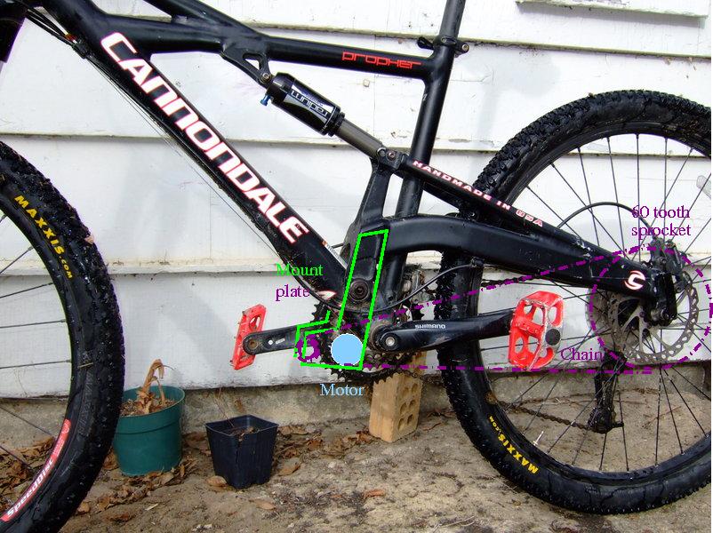

My second score was a used Cannondale Prophet. The geometry is perfect for my short wife. The frame design gives low stand over height despite the tall suspension. Now this one lends itself to an RC build. See next post. I'll be jealous of my wife...
You might ask why Cannondale aluminium frames? List rumour is that aluminium is not suitable for ebike building. Well, I have good experience with Cannondale frames, MTB, road and touring. They use relatively soft aluminium, compared to others, so hopefully cracking will be less of an issue. I also like the Cannondale engineering. We'll see how they hold up in a year of so.
Recently I came across an ad for a used Cannondale Prohet at a good price. The mono-pivot suspension link goes a bit in front of the cranks, and I'm hoping to attach some brackets that allow me to mount a drive system. Goals are: Motor mounted on the swingarm to be able to have a fixed chain length and avoid chain tensioner arrangements. Yet put the main weight (motor) as close th the pivot point to give low inertia, and low unsprung weight. (a kg at the hub affects handling much more than a kg near the pivot)
This is a crude overlay I did on a picture. I'll have to do detailed measurements and a stress analysis (Maybe a good FEM project).
The green lines outline an aluminium bracket to be fixed (screwed, epoxied or welded -- don't know exactly what alu is in the casting of the swingarm. Suspect 6061). A similar bracket will be on the other (pedal chain) side. For a prototype I will just cut the bracked out of sufficiently thick alu sheet. What's your guess of sheet thickness? 6mm ok? 8mm?
Between the two brackets there is 3" of space to mount a motor. One early thought was a low rpm, high torque pancake motor . A Mars would fit, but at 9-10kg it is almost the weight of the bike (14.5kg). My current better idea is to use a good RC motor and a two stage reduction.
Here's where Matt's offerings come in: The light blue circle indicates a 3" diameter motor, such as the Astro 32xx series. The 3215 is the closest fit lengtwise in the brackets. A regular bike chain drives a 12 to 60 tooth reduction to the wheel. I want to try to mount a 60 tooth roadie sprocket on the disc brake mount points. Maybe I'll just screw it to a disc with a size matching the 130 diametre road standard mount points, or if that is to wiggly I'll make an alu adapter. Then have to think of another rear brake arrangement. (rim, regen or a second larger disk on the same adapter.)
The first reduction stage will be on the other side. There is 35mm of space between the far side mount bracket and the pedalling cranks. The three front chain rings intrude in some spots so exact layout has to be considered. Here a belt, chain or gear reduction could be mounted. An alternative would be the Currie planetary that Amberwolf posted. It almost exactly matches the OD of the Astro and adds just 21mm, but as discussed in previous threads might be noisy.

Miles said:
How about using #219 chain, rather than bike chain? It would get you a greater reduction in the same space...
I'm open to ideas.
I had picked bike chain because I thought I would need 2 stage anyway, bike stuff is available everywhere, and the bike components design (particularly the large 60t sprocket) blends a bit better with the bike.
12t to 60t only gives you 5:1............ Using #219 chain, 12t to 92t gives you 7.7:1.............. More compact first stage or greater overall reduction.

I'm looking at a total of about 20:1 reduction. I had thought of splitting that somewhat evenly as 4:1 1st stage (will consider experiments with belt, chain or planetary) and 5:1 secondary, which is also the rear wheel drive chain. Is another split better?
Another option is of course higher torque motor and a single 8:1 or so stage. Not sure what motor to pick. An Astro 3220 would work, but is pricey. A larger diametre motor would be better. Used Mars can be inexpensive, but are heavy. I'm hoping to keep brackets, motor and any gearing at or below the 4kg range. Any suggestions for motors about 3" long but larger diam and higher torque than Astro?
Here are some figures of what I was hoping to achieve with a 4 turn Astro 3215
The 5 turn is listed at 200 rpm/v, so the 4turn would be 4 turn 250 rpm/V right?
For starters I have a bunch of DeWalt 8s packs, so I can get 26V or 52V nominal packs. Plan to get some cellman packs later. Was thinking 26V for the wife and 52V when I get to try it out :twisted: .
Motor rpm at no load, the standard -20%, and full loads interpolated (intelligently :?: guessed) from some of the Astro application examples:
RPMs:
V Noload -20% full load Power
26 6500 5200 4500 (1.4kW)
52 13000 10000 8-9000 (6kW)
With a 20:1 reduction:
motor rpm wheel speed
26V 4500 - >250 -> 30km/h
53V 10,000 rpm - >500rpm -> 60km/h

20:1 seems fine but, if the second stage was only 5:1, it would mean (for belt) something like a 72t pulley or larger on the first stage - that's why I suggested using the #219 chain. Just a suggestion - either would work.
There's not that much choice in motors of the size to do a direct drive for a bike - it's a pity...
