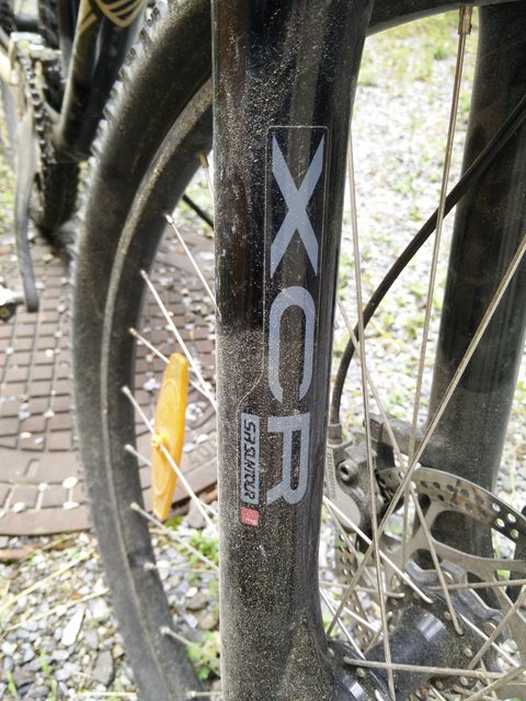

    - SA Suntour XCR front suspension
Flat on the front, dried out rubber tires...
Front brakes once ran too hot, now they don't brake well and make kinda weird noises
Apart from that in perfect condition. Probably okay for my first build.
Issues with this frame:
Crappy dropouts (?), hard to mount torque arms
Not so good front suspension

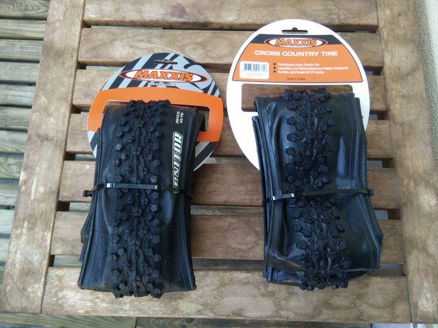

New Tires: 2 x Maxxis Ignitor 26" x 2.1 - received

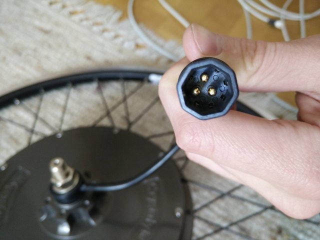

Crystalyte HT3525 with weird new connectors:
At first I was puzzled as there only seem to be 3 phase wire pins... but after a closer look 6 additional pins can be seen inside the connector!
After snipping off the plug, I found that this motor is indeed sensored, as it does have the hall sensor cables.
Because the motor axle already bit into the wires, they will be upgraded to 4mm² phase wires, covers will be drilled for cooling, although I haven't found a dick-shaped drill bit yet.

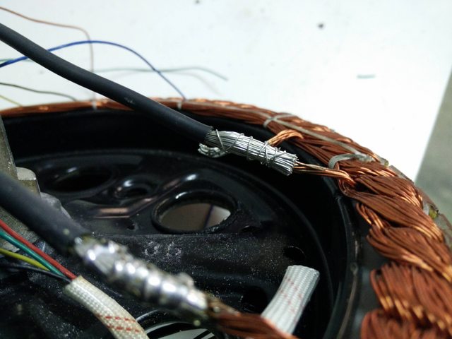

The first thing I did was upgrade the phase wires in the HT3525 to 4mm² silicon wires. I did have quite some trouble fitting those fat bastards into the stock axle groove, so I had to improvise a bit. I used a dremel to grind down the sharp edges on the axle and made the groove a bit bigger. Then I cut the silicon isolation off the wires for the length of the axle groove, removed about 6 strands from each wire and heatshrinked them. I was then able to fit them into the axle shaft with lots of cursing.
The other thing I did was installing the Adaptto temp resistor, pushed it into the windings with some thermal grease and high temp gasket silicone.
I really hope I did not cut the isolation somewhere when I pushed the bearings onto the axle.

Ground the axle groove out
New Wires
Tidying up
Sadly, I did not take any pictures where I replaced the wire insulation with heatshrink and closed the covers.

Tires

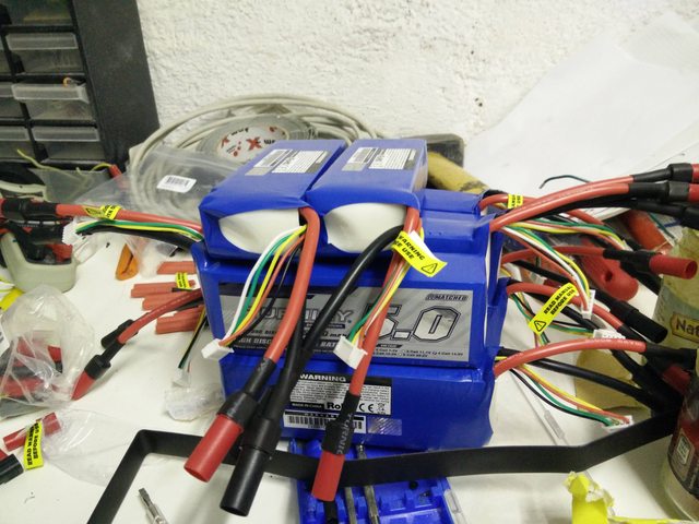

Last but not least: 6.5kg of pure LiPo-Power! (shipped with standard shipping (cost 7€), in that box...)

I soldered new XT150 Connectors onto my lipo's.

Soldered new end connectors to the batteries
