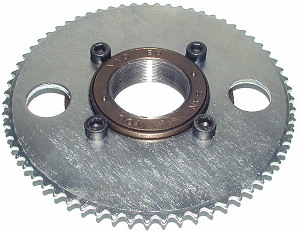

I'm trying to make a rear wheel for my latest scooter, and I don't understand how to make it.
I want to make a wheel with a bigger sprocket on the right side, and a disc brake, or drum brake on the left.
Others have found ways of attaching sprockets like this:
<img src="http://www.rqriley.com/imagespln/elchop-1.jpg">
It looks like he bolted it on in some way.
The problem is that I can buy a hub that accepts a disc brake like this:
http://cgi.ebay.com/DT-Swiss-Onyx-Disc-Rear-Hub-NEW_W0QQitemZ330127930399QQihZ014QQcategoryZ36143QQrdZ1QQcmdZViewItem
But they always seem to come with a cassette type adapter for the sprocket on the right side.
Can I replace the right side of the hub?
Also, I beleive that my motor sprocket is 25mm or 8mm or something. Its smaller than bicycle chain. I'd like to get a back sprocket that matches so I don't have to customize the sprocket on the motor.
Any ideas?
Another solution could be a drum brake hub. I've seen bmx hubs that are single gear with a drum brake. That would simplify my brake situation, but I would still have to attach the sprocket.
How are you guys tackling this problem?
Hey Beagle,
Most of the crew are running hub motors...
The hub you linked is 85 bucks. I got a whole bike with front/rear disk brakes for $80 at toysRus.
If your frame doesn't have lugs for the calipers, it could be a pain to make em. They gotta be kinda precise.
Randy Draper uses kart sprockets on his bike. They can take 8mm chain I think. There are some hacks for sprockets on the net, if you poke around.

However attaching a sprocket still remains as the major problem. I welded a sprocket on my last project. That's still a possibility, but centering can be an issue.
safe managed to attach disc brakes to his bike. I beleive they may have some adjustment in them so they don't have to be positioned perfectly.
This is also available:
http://losangeles.craigslist.org/sfv/bik/345893354.html
NICE!!! That looks great. I'll look for a hub to match.
I think we're on the verge of a solution. Look at the hub in the right column near the bottom of this page:
http://www.wildernessenergy.com/bargain_corner.html
I bet that would fit the gizmo you showed. And it fits disc brakes. The only thing better would be drum brakes I guess.
