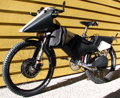

shenzhen_ex said:
20ah of A123's
I think it rides great (when it is not broken).
file.php
Sweet build...how many beers does that front mount ice chest hold?
Anything that puts a case >120mm wide between your knees is too much.
Not to mention if it begins to swell from over charging.... :lol:
At times good beer is all the fuel you need... :lol: Seriously though, this bike is an example of what a talented builder can do, IMHO.
