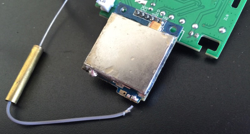

sadly, while handling the internals of the gt2b, the antenna just came off - does anyone know which of the 2 soldering spots is the shield/ground and which is the antenna? :(
p.s.: yea, I would just try it out, but the weather is nice for the next 2 days and I dont want to pick apart my board just yet - sadly on my board are the only ESCs I could use to test! :)
but the antenna is that transparent small cable in the middle, there is a shield/ground as well around the antenna cable within the grey cable - thats also going on the big soldering spot together with that shield within the grey cable?
I was thinking about that als well, unfortunately I don't have an other picture of that which shows this in detail. But from my memory the thinner (antenna) should be on the right and the thicker one (ground) on the left on your picture.

for the other people who might accidently tear off their antenna - this is the original soldering position:

Whitepony, what do you mean by one side goes on shield/ground and one on antenna? So the antenna cable is on left and shield/ground (the silvery bit?) on right?
