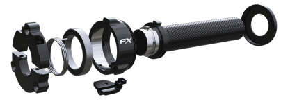

but bin eyeballing this FX Throttle for some days maybe Ill give them a shot once they are back in stock:
Fully CNC and they are 3 way adjustable in the spring tention.

That FX throttle looks nice, might be interesting to try. But I am rather happy with the surron throttle I use now.
I think I actually would want slightly shorter twist than it has though, I for sure don't want longer twist..
It is more aggressive than the ones I have had before though, I had to tune the throttle curve to get it rideable.
