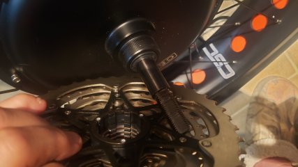

Hello,
I removed the cassette with the tool.

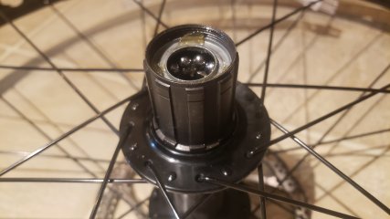

How can I fit the cassette on the threads of the motor wheel it is not the same fitting.
On the first image, you can see the cassette near the threads of the motor wheel, I am trying to figure how to ?
Do I have to buy a cassette that has threads instead of a kind of fitting that was on the original wheel ? (image 2)
Yes have to buy a threaded casette, commonly called a Freewheel
Hubs are designed to accept freewheels OR cassettes, not both. Your hub requires a freewheel, so you'll need to buy one, unless you return the hub for a cassette version.

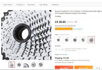

Hello guys,
I looked to buy a "thread-on freewheel" but all images look like "cassettes" as mine.
Are there threads behind the gears ? Do you have a link to suggest ? I have 9 gears on the cassette.
Thanks again.
The spacing/axle length of most hub motors allow for a 7 speed freewheel. Fitting 9 speeds would likely require several additional washers on the drive side and stretching the frame dropouts to accommodate the additional width. Search on 7 speed freewheel.
